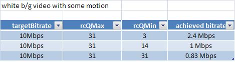

  • Akshay,
    pls  check the  below  table. This  is  for a  scene  with mostly white background and also some  fair  amount  of  motion in it.

  • Hi JK,
    With a stream like football, I get results like this.
    The result is not linear, obviously, but I guess this is what you had in mind?

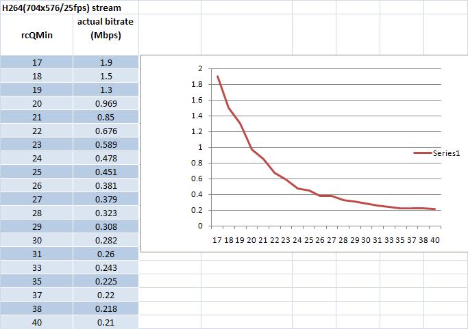

  • Hi Akshay,
    Today I have experimented  with an H264 Encoder(dm365_h264enc_02_10_00_06_production) and   got the  following  results.
    (same visual   scene as in the  earlier case)
    rateControlPreset=IVIDEO_STORAGE (VBR)
    rcQMax=44, targetBitrate=5Mbps
    For a still scene, a perfect curve is harder to achieve because of the introduction of skip MBs, intra MBs and the like. I do not know the specifics of the h264 rate control algorithm, but it might not operate in the same way as the MPEG4 one here.
    Hence, I would still suggest you to tie your quality metric to the targetBitRate parameter and empirically determine at what setting it gives acceptable visual quality for different scene types. This way, you would not be constraining the encoder to operate at a specific Q value. Allowing the encoder the flexibility to operate over a wider range of Q, will give better results as far as visual quality is concerned.
    Akshay
