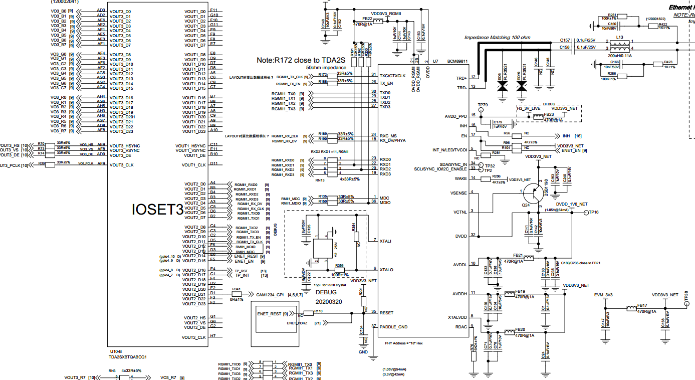

HI ,  I use the rgmii1  port  connect to BCM89811,and my dts is like this,

I  set the command "ifconfig eth0 192.168.208.110 up" then  look the kernel message:
[ 70.109299] net eth0: initializing cpsw version 1.15 (0)
[ 70.109315] net eth0: initialized cpsw ale version 1.4
[ 70.109325] net eth0: ALE Table size 1024
[ 70.116837] net eth0: phy found : id is : 0xae025022
[ 70.123702] IPv6: ADDRCONF(NETDEV_UP): eth0: link is not ready
why my eth0 is link is not well   wrok?

  • Hi ,now I  can link up eth1 ,how can  I set the  link  100Mbps/Half (now    is 10Mbps)
    my log is :
    [ 17.875266] net eth1: initializing cpsw version 1.15 (0)
    [ 17.875299] net eth0: initialized cpsw ale version 1.4
    [ 17.875309] net eth0: ALE Table size 1024
    [ 17.882989] net eth1: phy found : id is : 0xae025022
    [ 17.889122] IPv6: ADDRCONF(NETDEV_UP): eth1: link is not ready
    [ 23.879044] cpsw 48484000.ethernet eth1: Link is Up - 10Mbps/Half - flow control off
    [ 23.879129] IPv6: ADDRCONF(NETDEV_CHANGE): eth1: link becomes ready
  • Have you tried ethtool to change the speed/duplexity ?
