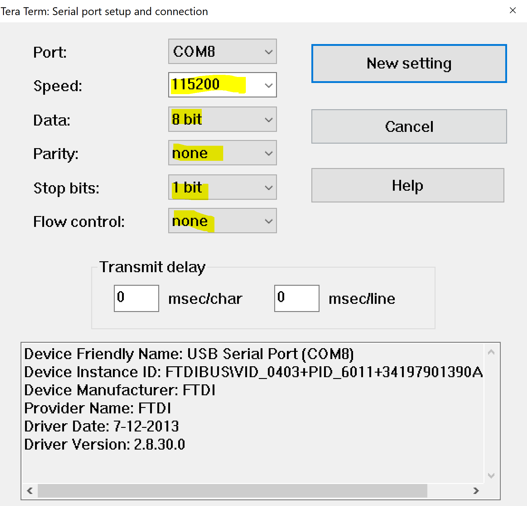

    When you connect to the MCU UART (connector J43) and check the ports (on windows) and /dev/ttyUSB* (on linux) you will see there are two instances (calling it 0 and 1). The prints will come on the 1st instance.
    Also, please verify your minicom/teraterm settings - it should be as below

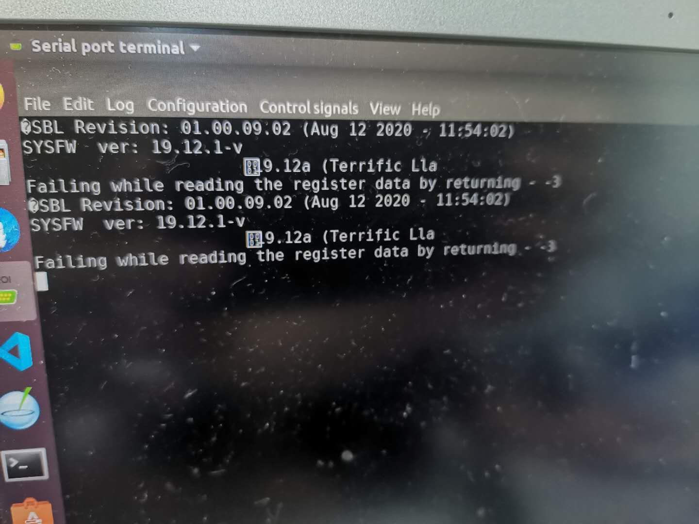

  • I done as you say, MCU uart printf fail reading the register data .Is there something wrong with my configuration
  • I think that is not the application print, some issue with the SBL or so. Can you please let me know which SDK are you on?
    Karan
  • psdk_rtos_auto_j7_06_02_00_21

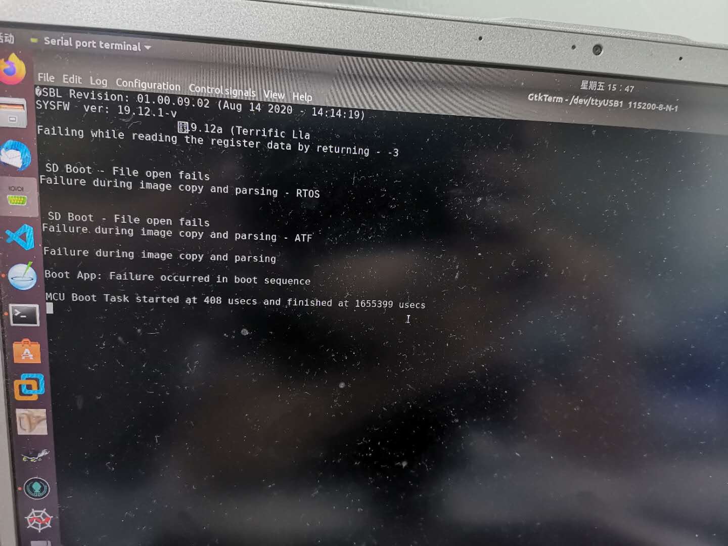

  •  I am sorry, there's a problem with my description. My questions are about can_profile, not can_app.It is ok follow your  advice to make can_app. But there are still questions about can_profile.
    The prints you are showing are from can_boot_app_mcu_rtos, this application needs other things apart from app, SBL and sysfw. Also this is intended for CAN response and hence needs faster boot mode and hence is supported only from OSPI not MMCSD by SBL.
    If you want to exercise CAN functionality, I suggest you use the can_profile_app (mcusw/mcuss_demos/profiling/can)
