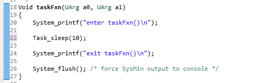

My problem is that when example task is called:
I can see on SysMin output only "enter taskFxn()". I'm able to stop on breakpoint at line 20 but on line 24, what proves that we're never back in this task.
My observation is that clock ticks do not increase:
Ticks counter is always 0
I've tried various settings in .cfg file, nothing was able change it. I checked also a lot of E2E threads but i didn't found solution to my issue.

    Have you called board_init() and other initialization functions ? Writing a CCS project from scratch for a complicated SoC like DRA929 can be tricky.
    Can you refer to a simple example application like pdk/packages/ti/drv/udma/examples/udma_memcpy_test ? which has an RTOS application built in ? and modify it as per your requirement ?
    Unfortunately for DRA829, CCS example projects are not yet supported so you will have to build using a Linux VM and makefile.
