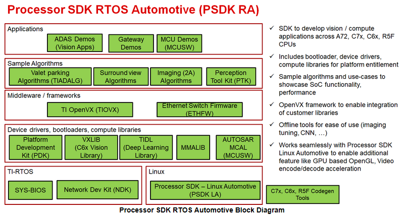

There is PSDKRA picture below,which shows the components within PSDKRA.Reading the description,I know the ADAS Demos and the PDK  run in R5f,C6x,C7x and A72;the TI-RTOS runs in R5f,C6x and C7x;Linux runs in A72;VXLIB runs in C6x;TIDL and MMALIB run in C7x;MCUSW  and ETHFW run in R5f.But I don't know which core does the TIADALG,PTK,TIOVX,Surround view Algorithms ,Imaging Algorithms and Gateway demos run.Can you help me solve it?
