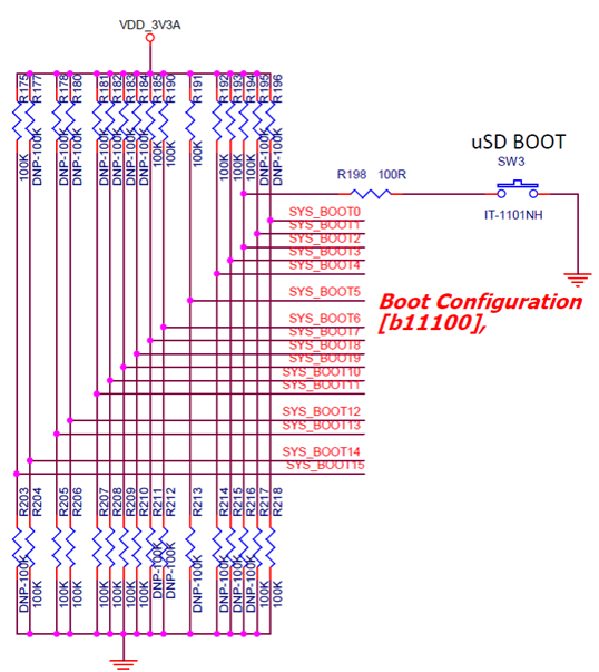

Hi everyone,
I am trying to bring up(porting) our custom board which based on BBB. But SPL/UBoot has some delay, like this. (always same delay)
Anyone experience this phenomenon or give me advice.
case1: UART boot
CCCCCCCC - (20sec pause) - CCCCCCCC - (20sec pause) - CCCCCCCC - (20sec pause) ...
case2: eMMC / uSD boot
(2min 30sec pause) - first SPL log at debug port
Thanks in advance
Justin

  • Hi Hong,
    Thanks for the prompt reply with a detailed explanation.
    However, I am still debugging this issue because it has not been resolved. (delay issue)
    I've been checking and comparing the checklists you gave me, but I haven't found anything strange yet.
    For reference, it is my SYSBOOT Configuration Pins setting and schematics (it is the same as BBB)
    1. SYSBOOT[4:0] = 11000b: SPI0 -> MMC0 -> USB0 -> UART0
    2. SYSBOOT[4:0] = 11100b: MMC1 -> MMC0 -> UART0 -> USB0
    In my case, there is a 20-second delay in the middle of the output  "CCCCCCCC".
    In other reference boards, "CCCCCCCC" is output without delay.
    Is the boot sequence repeating or not?
    For example SPI0 -> MMC0 -> USB0 -> UART0 -> SPI0 -> MMC0 -> USB0 -> UART0 -> SPI0....
    Best regards
    Justin
  • Hi Justin,
    I tested with SYSBOOT[4:0]=11000b on TI EVM, the continuous "CCCCC..." output on serial terminal.
    I'm not able to explain your observation.
    Will you be able to boot up to u-boot prompt?
    if yes, can we read SYSBOOT from CONTROL_STATUS register via "md.l 0x44E10040 1"
    -Hong
  • Dear Hong
    Thank you for your tip.
    This is a result. I think SYSBOOT pins are correct according to Figure 9-5.
    MMC boot:
    008103fc = 0000 0000 1000 0001 0000 0011 1111 1100
    SD boot:
    008103f8 = 0000 0000 1000 0001 0000 0011 1111 1000
    BR
    Justin
