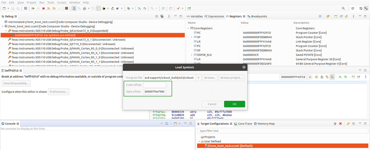

It mentions a method to debug the uboot spl. We would like to use the same way to debug the u-boot.img so that we could solve the problem with the u-boot drivers issue on our board.
However,  we found that we could not get the correct u-boot symbol after we connect the target "CortexA72_0_0". There seems to be an offset between the symbol  "board-support/u-boot_build/a53/u-boot" and the code. We would like to know what is the offset here.

  • Hi Keerthy,
    Thanks for your relay. Glad to have the offset. However, it does not take effect when I write the offset into the blank.
    In fact, I have tried every possible combination between  "code offset" and "data offset" with the 0x000000007f6e7000.
    Could you please tell me how to fill the blank below so that the symbol could be found? Thanks for your help!
    Yuan

  • Hi Yuan,
    I am able to reproduce this issue and I haven't been able to find a solution yet. We have reached out to other internal teams to get some additional help. But this process could take longer and therefore I suggest you to look for alternate solutions and update this thread if you have been able to make progress. I will also keep you posted as soon as we have additional information.
