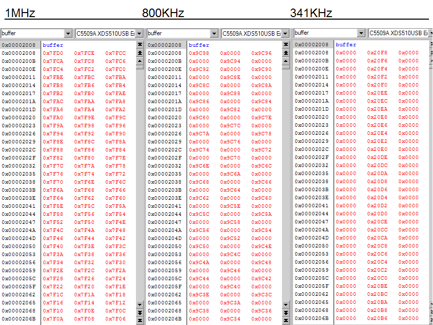

    It seems that the act of stopping the timer and re-loading the TIM0 and PRSC0 registers caused the ERRTIM bit to be set only if the clock applied on the Tin/Tout pin (configured as Timer0 Running from an External Clock) had a frequency below 1MHz.  When the frequency was above 1MHz the error bit was not set.  Is there a restriction on the input clock speed?  The 5509A data sheet does not give a lower bound for input clock frequency.
    Is the reading of TIM0 dependent on the speed of the clock input to Timer0?  It seems that if the input to Timer0 is more than 1MHz, we CAN read TIM0 accurately after we stop the timer or while the timer is running.  If we read TIM0 while the clock input to Timer0 is below 1MHz, we notice a pattern.
    When we made consecutive reads of TIM0 in a loop:
    @ f = 800kHz  we get a proper value alternating with 0x0000.
    @ f = 100kHz we get a proper value every 10 readings, the rest filled with 0x0000.
    @ f = 50kHz we get a proper value every 20 readings, the rest filled with 0x0000.
    Is this pattern expected?  I can find no restrictions in the data sheet or the timers reference guide that mentions this.
    Any ideas?  We can work around this if the above behavior is guaranteed.

    I was able to reproduce your results on the C5509A with the Timer Running From an External Clock. See below.
    There does seem to be an interesting correlation between the period of the input signal and the number of zeros observed between each proper reading.
                Freq = 800kHz (T = 1.25 uS) --> proper value alternating with 0x0000
                Freq = 100kHz (T = 10 uS) --> proper value every 10 readings, the rest filled with 0x0000
                Freq = 50kHz  (T = 20 uS) --> proper value every 20 readings, the rest filled with 0x0000

    The timer peripheral is being clocked externally, so I suspect that any register access to that peripheral will be allowed at the frequency of the external clock. Have you been able to scale the behavior by changing your system clock - i.e. keep the timer clkin signal stable at a frequency below 1MHz but slow down the system clock considerably to see if reading the timer registers returns 0x0000 values less frequently?
    Have you discovered any new behavior that may help the diagnosis?
    Are you able to move forward with this timer behavior and a workaround?
    Mark
  • Mark,
    Thanks for getting back to me.
    That is a good idea to slow down the system clock and see what changes.  We will have to give that a try when we get the chance.
    The good news is that the behavior we have seen seems to be completely stable.  Our workaround is to only use the timer when the CLKIN is above 1MHz.  We can deal with this and are fairly confident, but of course it would be great to have you guys be able to confirm that is expected behavior.
