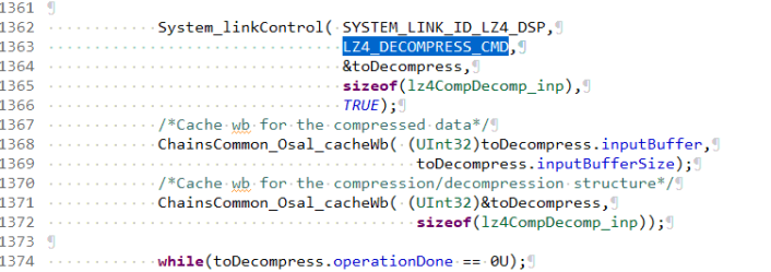

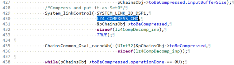

    • By default, lz4 link is enabled only for the below Algorithm
    Do the same changes for your algorithm.
    File:
    • To compress the data, you have to send the command to the lz4 link as below.
    • To  decompress the data, you have to send the command to the lz4 link as below.
    For more information, refer apps\src\rtos\common_srv\chains_common_srv_calib.c source file.
    Gaviraju
