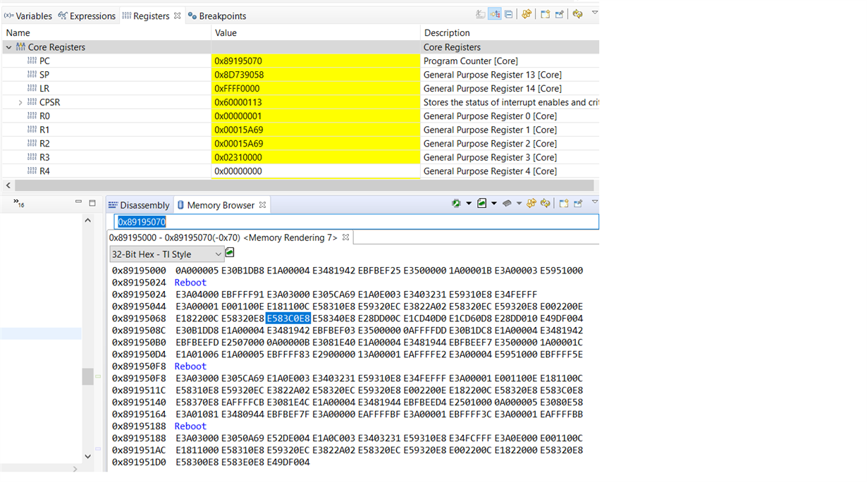

    I am using 66AK2G12_BlackHawk, the reset button is a part of the board itself. The emulator that is connected over BlackHawk shows that there is a reset applied when I do soft reset by software but it doesn't show the same when I do hard reset by software.
    the BOOTCFG_DEVSTAT register value is:
    0x02620020        0x00060395
    the boot mode is XIP
    The PC = 0x89195070  when the serial port is responsive and just before the system crashes. JTAG is disconnected and no way to communicate with the board unless I reset (switch off and on the power).
    the ARM code start address and length are respectively : DDR0_ARM_CODE    :  o = 0x89000000, l = 0x04000000, the last readable PC value 0x89195070   is within this area..
    implementing Hard reset by software: A snapshot of the memory browser around the PC value at the time just before the system crashes is attached:
    when implementing Soft reset by software: the PC takes values such as 0x89195070   then  0x0000083C, then 0x00014858 before it stops responding.
    I tried to isolate some of the clocks from reset by assigning values to the register RSISO but the register did not change and did not accept writing to it.
    Best regards
    S.S

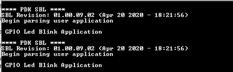

    I did a test by copying two files processor_sdk_rtos_k2g_6_03_00_106\prebuilt-sdcards\evmK2G\sd_card_files into a MMCSD card, one file is the bootloader (MLO), the second file is a LED blinking application (APP). The boot sequence is ROM bootloader------>MLO----->App.
    I set the boot mode to MMCSD boot mode by dip switch: 0x2620020 = 0x000E009D
    I was able to see some boot info printed on the UART and LED is blinking after power on.
    Then I halt the ARM core, I knew the PC is inside DDR3 (LED stopped blinking as ARM core halts). Then I did the hard reset from software (I didn't run any code, just use CCS memory browser to write the registers to do reset), I immediately lost the JTAG. But the UART prints out the same boot info and LED starts to blink again.
    So, it looks the hard reset can work at least in MMCSD boot mode. For XIP boot mode, we don't have any work example for this. The K2G EVM supports QSPI 48 boot mode, not XIP. Are you able to try MMCSD boot + hard reset on your blackhawk EVM?
    Regards, Eric
