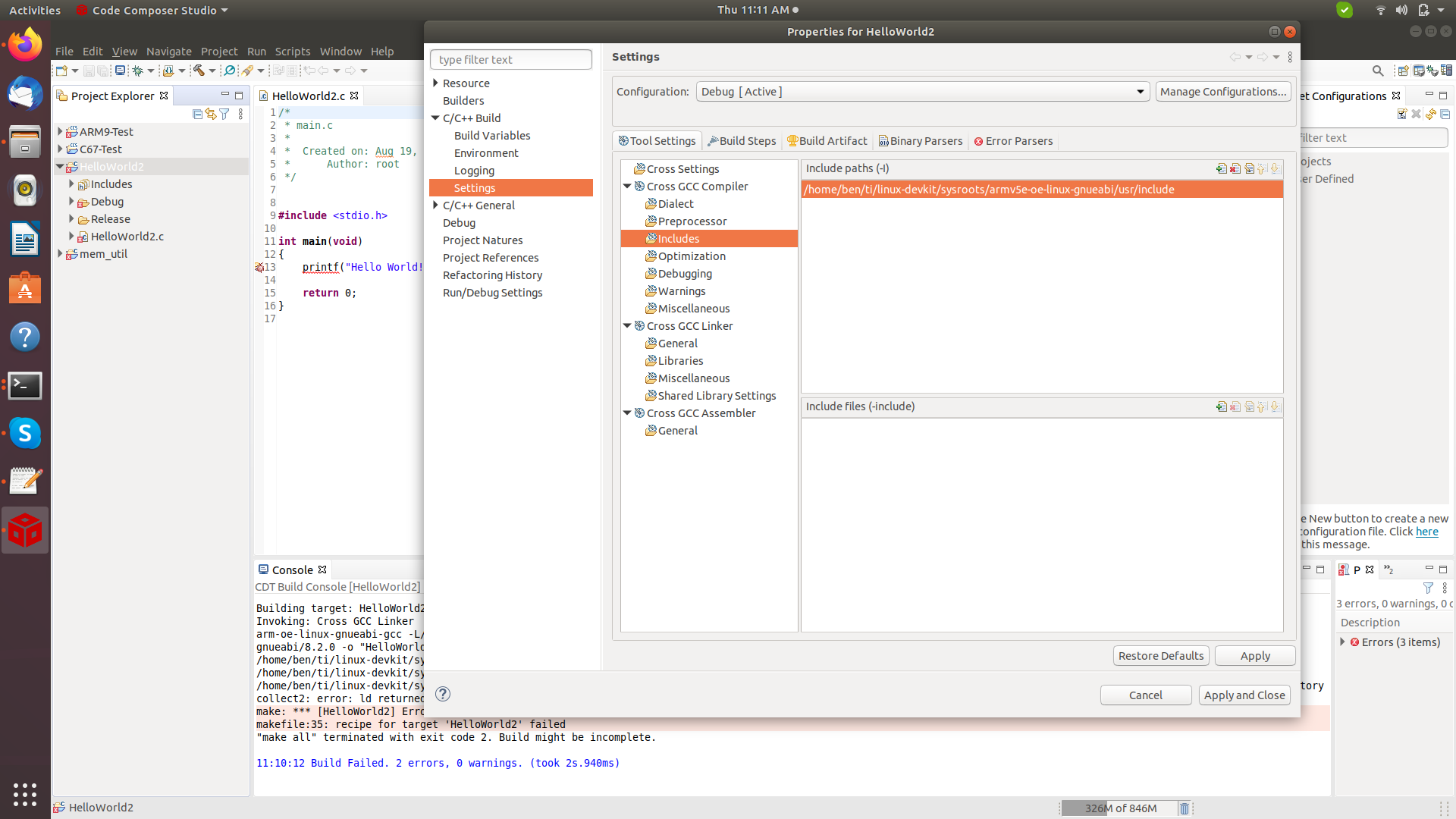

I've been trying to cross compile a simple hello world example in CCS v10 for execution on the OMAP-L138 LCDK dev board (program shown below)
#include <stdio.h>
int main(void)
    printf("Hello World!\n");
    return 0;
I downloaded and installed the OMAP-L138 Linux SDK according to the documentation from TI, but I have compilation and linker errors I've been trying to sort out.
One of the compilation errors was that the compiler could not find the file stdio.h which was located at the top of the hello world program.
I thought I must have to reference the directory stdio.h resided in as an include path for my project.
I added the following include directory to my project "/home/ben/ti-processor-sdk-linux-omapl138-lcdk-06.03.00.106/linux-devkit/sysroots/armv5e-oe-linux-gnueabi/usr/include" which resolved the file not being found issue (picture of it below too).
After compiling the project again I still got the linker errors (shown below the console output of the project)

I started looking around for the files and their locations and decided to add the below directories to the linker include paths (picture of project configuration shown below):
/home/ben/ti/linux-devkit/sysroots/armv5e-oe-linux-gnueabi/lib
/home/ben/ti/linux-devkit/sysroots/armv5e-oe-linux-gnueabi/usr/lib/arm-oe-linux-gnueabi/8.2.0
This solved some of the issues, but not all the linker file errors.

  • Hi Rex,
    That solved my issue.  I just had to add the below to my linker options and it linked no problem:
    --sysroot=/home/ben/ti-processor-sdk-linux-omapl138-lcdk-06.00.00.07/linux-devkit/sysroots/armv5e-oe-linux-gnueabi/
    I then took the executable image and ran it on the SD card from the root file system and it ran with no issue.
    I'm wondering if something in the setup script didn't execute properly when installing the SDK?
    If that is the case though, perhaps other areas were not configured properly too.
    Either way, this is a good thing for now!
