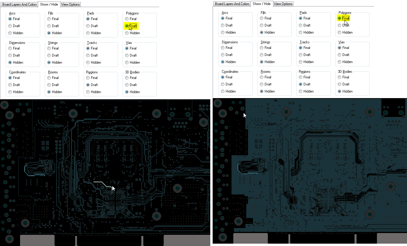

Hi All,
I have found that with the EVM6437 board which I am studying, in all layers there are large area of polygons which has areas dozens of times to that of tracks.
The attached picture show a comparison on Mid-layer 2 when Polygon display is switched between "draft" and "final", and the difference is clear.
I searched and read some articles on the Internet about polygon areas in PCB, but still haven't understood it well.
Isn't that tracks themselves alone are sufficient for carrying signals? Some large areas of copper might be useful on power or ground planes, as well as for EM shielding. However, why on all SIGNAL layers do there exist such large areas of polygon (copper?), which gives the impression that they are primary and the tracks are secondary?
My view is that if tracks are needed, some small portion would be enough, and they ought to be mostly on power/ground planes. But why there are so much of them, to the extent that they are the predominant, on all signal layers of the board?
Hope someone could help with this.
Zheng
    Adding to the previous question:
    This first newly attached picture shows the polygon on several layers. The top sub-picture is the zoom-in view of an area on mid layer 2, and in this view it can be seen that the all GND vias are connected to the copper polygon fill.
    The following figures shows the transparent polygon overlaid on
    as well as all six signals (adding Mid-layer 4 & Bottom layer) shown together.
    And the second newly attached figure shows the board's three internal layers.
    My question is still on the purpose of polygon layer.
    In the first sub-figure of the newly attached figure 1, and in fact in all signal layers, large areas of polygon fill are solely connected to GND vias. But why no polygon fill with VCC vias?
    Shouldn't they be symmetric? What is the purpose of polygon layers?
