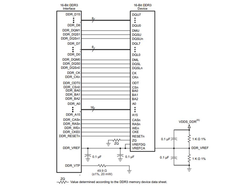

  • Sr. Thank you very much for your answer, it is of great help for our company; In this moment we have a production retained because of this problem.
    We have based our design in am437x_starterkit_evm_3k0009.dsn, and we are using AM4372
    We have a difference respect to am437x_starterkit_evm_3k0009.dsn in RAM, attached general image of our RAM connection:
    We have the following problem: the system does not boot and we need to determine if it is because of the hardware.
    According to my understanding to achieve the operative system works it is required that AM4372, RAM and microSD they all work correctly.
    I need to determine if interaction between they is ok or not; How can I do it? What must I test?
    Our SYSBOOT pin setting is: SYSBOOT[18...0] = 0000100000000001100.
    Another difference in my custom design is that I haven't the 1Mohm resitor in parallel with the 24Mhz crystal. This can be it the reason of my problem?
    Can I send you a message in private with our design for your evaluation?
    Is it possible that the problem is about software? How can I determine it?
    I am the hardware engineer and we have other engineer who works in the baseline SW. I am assuming that the problem is in hardware because I think that the problem in hardware is more probable than the problem in software.
    Anyway I will ask our software engineer about the baseline SW and I will reply you.
    Sincerely, Thank you very much. Best regards
  • Hi Alberto,
    There're good reference available for AM437x schematic checklist… plus further links from there on DDR, PMIC, High speed layout…
    http://processors.wiki.ti.com/index.php/AM437x_Schematic_Checklist
    We'll still need to understand the baseline SW you’re testing with on your board in order for us to help.
    -Hong

  • Hi Alberto,
    Unless the HW design is exactly the same as TI reference EVM, then most likely it is necessary to porting SW, where a general board porting guideline was posted early.
    Also using JTAG debugger for initial board bring-up approves to be very useful. Another option is to enable "early UART print in SPL",  where how-to steps are outlined in the same board porting guide.
    Regarding customer schematic review, you would need to request it through your local TI team.
    -Hong
