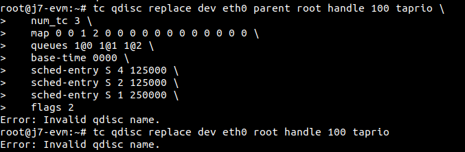

Kaijun,
For this error, it is likely that
- Modules not loaded or present on rootfs
- !CONFIG_NET_SCH_TAPRIO
- old iproute2 package tools
Please check and confirm.
