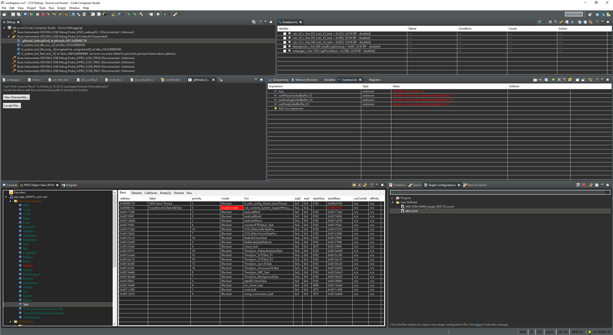

2.) I'm currently upgrading TI software (PRU-ICSS-HSR-PRP-DAN and TI RTOS) on our project on custom board and I face many problems. Because I had doubts about memory settings and heap I check ROV and found funny data. Then I start looking back where "funny" thinks start happening. So now I run "prp_app" in initial state with PRSDK-8424 and 3086 patch in debug mode on IDK AM437 board and found this:
Why Fxn is changed??? taskLedBlink2 and RedLifeCheckTask are multiplied over other task functions. Is this ROV problem or application memory problem?

    2) It's interesting that the priority of the same task changes as well. I don't think there should be so much priority inversion happening here. With the ROV snapshot, do you see any problem when running the application on IDK?

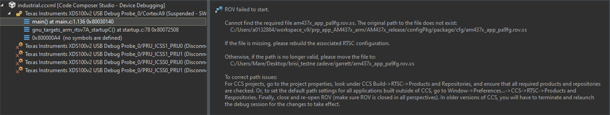

  • https://e2e.ti.com/cfs-file/__key/communityserver-discussions-components-files/791/AM437x_5F00_release.7z
    Mare,
    I zipped the entire AM437x_release folder in the attachment.
    Garrett
  • Hi Garrett,
    let me thank you first for your respond and attachment!
    As you can see in the picture, ROV shows the same issue with your build.
    Is that ROV or my CCS issue or it is prp_app or something else... I don't know, but the founding solution is our number one priority. We stop OS and PRP/HSR update on our product until basic software is clear of issues.

  • Hi Garett,
    We also try your build with old CCS (Version: 7.2.0.00013):
    Fxn seems ok on queek look. So is that CCS or XDS problem nor project? Some priorities of tasks are still strange, or not? NDK task on priority 2?
  • Hi Mare,
    I finally got a working IDK and able to see the repeated task issue from ROV with CCS v9.3. Let me check with CCS team to see if there is any known ROV issue with the CCS version.
    With the CCSv7.2, does the project work as expected or still behaves as CCSv9.3 except ROV?
    Garrett

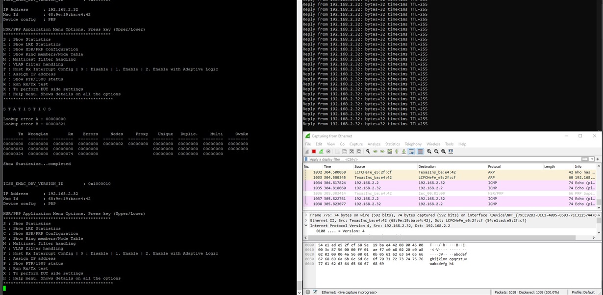

  • Hi Garrett,
    thanks for the feedback!
    I will be very happy if you can give me also feedback on the points below.
    1.) CCS7.2 - Other problems such a memory strange behaviour suddenly disappeared (ROV remain)... Not sure how and why... maybe I can't see it at this moment and problems still remain?! I will report about that if I found anything suspicious.
    2.) CCS7.2 & CCS930 - What I can confirm is that obviously PTP on port2 doesn't work! Some times also port1 fail to sync (maybe traffic with sampled values help to crash synchronization - 16.8Mbps). Is this issue known? Do you have option to plug your IDK on PTP source? I'm not sure if I will able to, but should I try to debug what is missing for successful sync? (my settings: IEEE802.3/P2P)
    3.) Also when I debug "2.)" issue I pause debug execution for five seconds and after I press run in IDE I was realised that IDK freeze. What I found is that program looping on HWI (void lisrEdma3CCErrHandler0(uint32_t edma3InstanceId)) and it can't recover from Edma error handler. I agree that this isn't something surprising behaviour if I stop CPU with a debugger, but that also happens many times in our product application which is based on older PRU-ISCC-HSR-PRP-DAN release (application is based on prp_app example) without "pausing" code execution. This application has many interrupts and some critical parts where I disable HWI for short time... Are you have any recommendations or guides, what application shouldn't use for PTP driver stability? When I remove lines for PTP handling from "processHighPrioFrames" this issue was solved (but lose PTP functionality), so I'm sure that EDMA problem comes from PTP driver (EDMA set a timer on ICSS?) . Have you ever see this kind of issue? Could "signal traffic" inside CPU or busy CPU cause such problem?
    Edit: When I was writing this, Edma loop in error handler happen again... without stopping the code executing.
    4.) I look around but didn't found a description of statistic from USART menu:
    S T A T I S T I C S
    Lookup error A : 00001179
    Lookup error B : 03040845
          Tx  WrongLan        Rx    Errors     Nodes     Proxy    Unique   Duplic.     Multi     OwnRx
    00002139  00000000  00000000  00007534  00000000  00000000  00000000  00000000  00000000  00000000
    00000306  00000093  00000000  05455215                      00000000  00000000  00000000  00000000
    03041912  00000000  00000156  00000000                      00000000  00000000  00000000
    Show Statistics...completed
    What I'm trying to understand from statistic is:
    4.a)What are Lookup errors and how different to Errors in table?
    4.b)What represents first, the second, third line in the table? 1. LRE-port1? 2. LRE-port2? DAN port?
    What kind of errors are this? Wrong size? Packet CRC fail?
    Best regards, Mare
  • Mare,
    For ROV issue, I have asked CCS team to provide a know issue list of CCS v9 and v10.
    I don't really have a PTP source, will ask our testing team to try reproduce the issue you observed.
    For statics (lookup/Rx error), some info in the wiki may help:
    The first two lines corresponds to port 0 and 1. And the third line corresponds to application/host port.
    Rx error is logged if a packet shows following properties:
    • A packet received with source address same as the DUT MAC address.
    • A packet with CRC error.
    • An oversized packet.
    • A PTP packet that needs to be dropped.
    Garrett

    I was told there is no ROV in CCSv9.3+ and PTP/EDMA issue in PRP. But our RTOS kernel team is helping to look into more details on the ROV issue.
    Garrett

    I had a debugging session with RTOS kernel team and found that the 'Runtime Object View' tool under 'ROV Classic' in CCS->Tools lists the tasks properly, please give it a try and see if it helps you debug the PTP issue. We will look into the 'ROV Classic' issue sepearately.
    Garrett

    Names look OK, but priority on NDK stack -> 2 seems to be too low? And PTP sync handling on priority 15?
    Anything new from the testing group?

    I didn't check NDK stack priority which should align with the settings in .cfg file. Yes, PTP sync handling on Priority 15 per the design:
    * @def PTP_SYNC_TASK_PRIORITY
    * Priority of task which processes sync frame
    #define PTP_SYNC_TASK_PRIORITY 15
