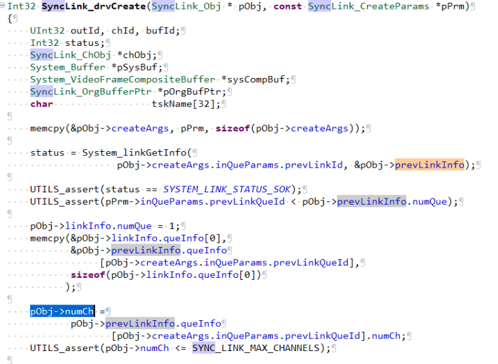

I'm running TI-RTOS Vision SDK v03.05 on TDA2sx.
chains: Capture -> ... -> Alg_FrameCopy (DSP1) -> Sync -> ...
Capture is 4 channels.
The numChannelsUsed of Alg_FrameCopy was changed from 1 to 4.
In Alg_FrameCopy link, 4 channels will be dropped by 2 channels, so Output CH = 2
In Sync link, pObj->numCh is still 4, the result is Input CH: 2, Output CH: 0
How do I make Sync receive the numCh of Alg_FrameCopy as 2?
Could you please give some suggestion here?
