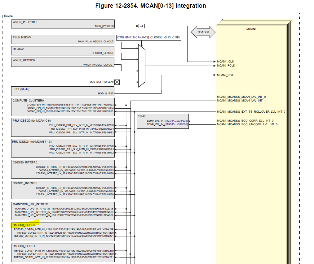

    1. Is the use case where you want to use MAIN domain CAN namely MCAN0 and control it using the MCU2_0 (R5FSS0_CORE0)? Please confirm.
    2. If answer to 1 is yes then the MCAN0 interrupt to the MCU2_0 doesn't go through the interrupt router. (see below fig in TRM)
    1. Is there a reason why you want to control CAN from MCU2_0 instead of MCU2_1?
    Karan

  • Hi Kepei,
    buaawkp said:
    Does "the MCAN0 interrupt to the MCU2_0 doesn't go through the interrupt router" mean that I do not need to execute this line of code?
    Yes, and you figured it our correctly.
    I was saying this as the csl_mcan_evm_loopback_app which you took reference from was supported on mcu1_0 and mcu2_1. See psdk_rtos_auto_j7_06_02_00_21/pdk/packages/ti/csl/csl_component.mk
    csl_mcan_evm_loopback_app_$(SOC)_CORELIST = mcu1_0 mcu2_1
    Otherwise there is no HW restriction to control any CAN instance from any core.
    buaawkp said:
    I removed a line of print statements in the sending interrupt, and now the sending interrupt is normal.
    On this, even though it is working - what code did you have to change? Can you send me the source code highlighting the changes?
    Karan

  • Hi Kepei,
    That would be a problem to have prints in the ISR. I would suggest if you need to count the number of interrupts then you add a global variable and increment it at the beginning (instead of the print)
    So something like:
    uint32_t intrCnt = 0;
    static void McanIntr0ISR(uintptr_t arg)
        intrCnt++;
    Karan
