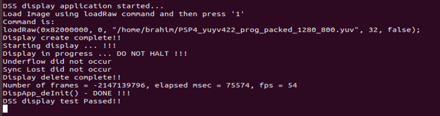

I'm using DSS examples to test SerDes products using J721E evm. I'm using SDK 06.02.00.
I want to launch the test pattern though DSI FPD-Link, this is my configuration in dss_display_test.h header file:
The DSI FPD-Link output is connected to UH948 deserializer. When I launch the test with CCS, the deserializer is not locked that means it doesn't receive any data from serializer (UB941).
1) Do you have any idea what the problem could be?
I connected USB2ANY adapter to SDA1 and SCL1 of UB941, I can generate a pattern with Analog LaunchPAD, in this case the deserializer is locked and can see the patternon the screen but it doesn't work with DSS examples.
With USB2ANY, I read the pixel clock, it's 152 MHz
2) Do you know how to change pixel clock for DSI ?
I changed it in the code in dss_display_test.c but it stays always 152 Mhz.
