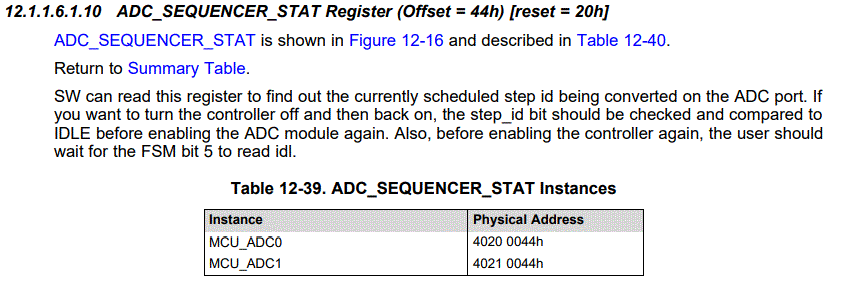

I have written some code( A53 ) to access the below register
typedef struct
union {
uint32_t ADC_SEQUENCER;
volatile struct
uint32_t step_idle : 5;
uint32_t fsm_busy : 1;
uint32_t mem_init_done : 1;
uint32_t reserved : 25;
}STATUS;
}ADC0_SEQUENCER, ADC1_SEQUENCER;
#define ADC0_SEQUENCER ( *( (volatile ADC0_SEQUENCER* )0x40200044) )
#define ADC1_SEQUENCER ( *( (volatile ADC1_SEQUENCER* )0x40210044) )
then to read the register:
uint32_t a = ADC0_SEQUENCER.ADC_SEQUENCER;
a = a; // test
This cause the processor to exit on a fault… Is there any obvious reason for this.
Does the domain need to change ?
I have used the above code to access the PADCONFIG registers...no problems….but this is in a different DOMAIN….I’m not sure if this is relavant?
Some guidance, code would be appreciated.

  • Hello Carl,
    a few thoughts on your issue:
    - is the memory accessible in the debugger memory view, e.g. if you put a breakpoint BEFORE the crash?
    - did you add the memory ranges for the ADCs to the MMU page table?
    - personally I find bitfields used to access device registers "scary" - i wouldn't be sure exactly HOW the compiler outputs the access. if the memory is accessible in the debugger view, but your code crashes, you should check the disassembly at the point where it crashes
    Dominic

  • Hello Carl,
    if your application is based on the rtos template app you should have a InitMmu function with lots of calls to Mmu_map.
    Just add a mapping for the ADC range(s). Physical address and virtual address should usually be the same, all of the TI code is using a 1:1 mapping. Size probably needs to be aligned to 4KB.
    It's possible that your application crashes BEFORE main if you add mappings. In that case the MMU table array length needs to be increased in the config file:
    var Mmu = xdc.useModule('ti.sysbios.family.arm.v8a.Mmu');
    Mmu.initFunc = "&InitMmu";
    Mmu.tableArrayLen = 24;
    It's kind of hard to tell WHEN the MMU table array needs to be increased, because it's not "1x Mmu_map" = "1 table entry", but rather depending on which virtual addresses get mapped, and how fine-grained the mappings are.
    Dominic

    I ended up with this
    mapIdx++;
    retVal = Mmu_map(0x40200000, 0x40200000, 0x00002000, &attrs); /* adc0 */
    if(retVal == FALSE)
    goto mmu_exit;
    The size seems to works in increments of 1000h and Virtual Memory mapping is like for like...just like you said
    I can read the data ..its visible...
