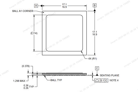

• Packaging related: What is the minimum chip height of TDA2EGBHQCBDRQ1? Only the maximum is 1.298

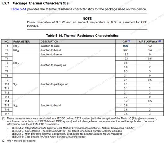

• Thermal performance related: Is there any data on individual chip heating differences? Is there a thermal resistance parameter in the case of 6W?
