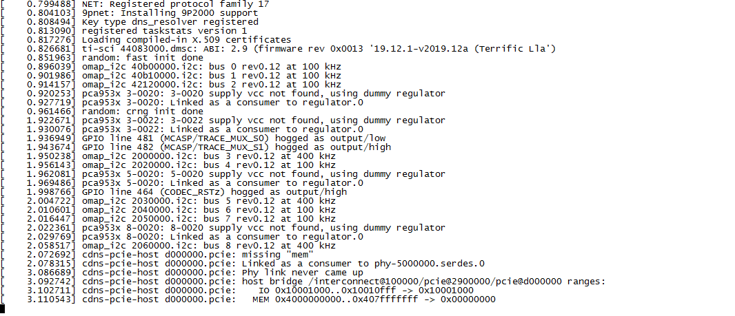

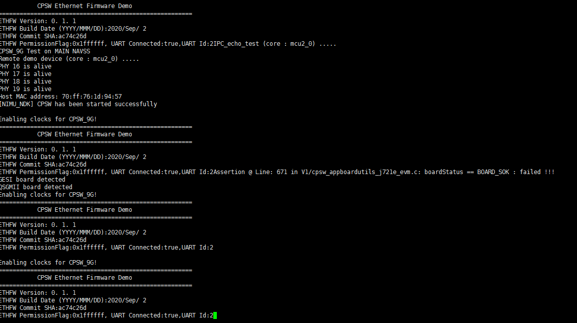

Hi, I  run the  Ethernet Firmwar,demo, then log stop here.Linux also stop here.what is wrong I do? thanks!

    Can you confirm which version of appsutils you are using? There are two CPSW apputils are currently included:
    • cpsw_apputils – excludes QSGMII/I2C support (default)
    • cpsw_apputils_full –includes QSGMII/I2C support
    Right now it's not supported to use both QSGMII and PCIe concurrently. This is a software limitation for the SerDes initialization that is not yet included to the SDK.
