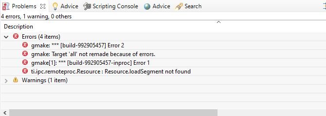

I'm using AM5718 with TI_RTOS,currently i'm trying to add IPC  to an existing TI-RTOS application on slave cores,I followed your procedure from the below link
Adding IPC to an Existing TI-RTOS Application on slave cores
 But at the end of these steps an error message was generated like below
it's already defined in my 'gpio_test_idkAM571x.cfg' file

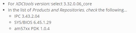

In my project IPC,NDK,SYS/BIOS,PDK versions are as follows:
 IPC  version         : 3.50.3.04
NDK version          : 3.40.1.01
SYS/BIOS version : 6.73.1.01
PDK version          : 1.0.13
XDC tool version   :3.50.8.24
In your description it is
Is it possible to download this versions directly? Here it describes PDK version.What will be the SDK version of corresponding  file?
My project file:
GPIO_LedBlink_idkAM571x_c66xTestProject_with_IPC.rar
How we resolve this problem?
Was it due to our default platform file 'ti.platforms.evmDRA7XX'?? Please share the procedure to configure our platform file or corresponding platform file with me..
Please share PDK,NDK,XDC,SYS/BIOS files,(if it is due to the mismatch of PDK,NDK,XDC,SYS/BIOS Versions )
