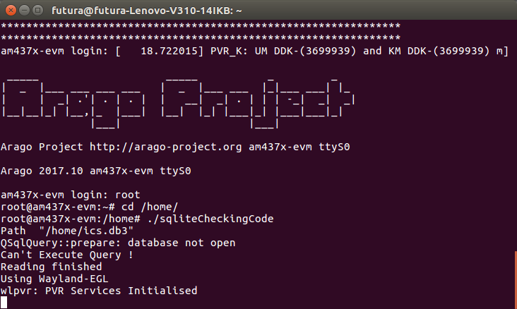

Here I created a database file with.db3extension and I want to link that to qt application. I did that application compiled I builder sqlite packages and loaded them to Target side as well as devkit side.
But now after compiling when loaded to SD card for am437x it is showing as unable to load qquery.
So any package do I have to build or sqlite3and sqliteus enough?
If so how to link my .db3 file to qt application .

  • Hello Lavanya,
    I apologize for the delayed response but I got your application to work on my setup. I am using a AM437x EVM and I am running our latest PSDK6.3. After running your application, I saw the following prompt on my terminal:
    root@am437x-evm:~# ./sqliteCheckingCode --platform eglfs
    Path  "/home/root/ics.db3"
    Path inside isDriverAvailable function  "/home/root/ics.db3"
    TERMINAL_ID :  "32"
    TERMINAL_NAME :  "WLAN-2"
    Priority :  "High"
    Default_Group_Number :  "1"
    Group_Numbers :  "1 ,2 ,3 ,4 ,5"
    Main_BroadCast :  "0"
    Conference_Dial :  "8888"
    Reading finished
    Here are the steps that I used:
    1. git clone git://arago-project.org/git/projects/oe-layersetup.git tisdk
    2. cd tisdk
    3. ./oe-layertool-setup.sh -f configs/processor-sdk/processor-sdk-06.03.00.106-config.txt
    4. cd build
    5. . conf/setenv
    6. export TOOLCHAIN_PATH_ARMV7=$HOME/gcc-arm-8.3-2019.03-x86_64-arm-linux-gnueabihf
    7. Navigate to the following directory "/tisdk/sources/meta-arago/meta-arago-distro/recipes-qt/qt5" and add the following line: PACKAGECONFIG_append = " sql-sqlite" in the file "qtbase_%.bbappend"
    8. Navigate back to the build folder and run the command "MACHINE=am437x-evm bitbake qtbase"
    9. Upon successfully build, navigate to the directory "tisdk/build/arago-tmp-external-arm-toolchain/work/armv7at2hf-neon-linux-gnueabi/qtbase/5.11.3+gitAUTOINC+08de243eaa-r0.arago17.tisdk5.7/temp" and open the file "log.do_configure". Please make sure that "SQLite" is set to yes.
    10. Navigate to the directory "/tisdk/build/arago-tmp-external-arm-toolchain/work/armv7at2hf-neon-linux-gnueabi/qtbase/5.11.3+gitAUTOINC+08de243eaa-r0.arago17.tisdk5.7/deploy-ipks/armv7at2hf-neon" and copy all the ipks to the filesystem
    11. Boot your EVM and run the command "opkg install *.ipk" (will take some time to install)
    The issue was that the SQLite application is expecting the driver to be present in the "/usr/lib/plugins/sqldrivers" directory. After installing the ipk, I noticed that the driver was installed and I was able to run the application.

  • Hi Krunal,
    As you explained in the last but one message i applied the same in sdk 04.02 vesrion(since i had some boot issues in sdk 06.03.00.103) but the issue have solved little bit. like earlier on gui sqlite libraries not installed properly so foe qdebug statement it is shown blank of no libraries present.
    but after installing 11 ipk files which present in builded qtbase folder the issue solved . but still had some issues.
    1.opkg install to some ipk files is showing cannot downgrade so did force reinstall to downgrade version with the following command
    opkg install --force-reinstall --force-depends --force-downgrade .ipk
    then all ipks installed but showing some warnings as shown in the pic attched.
    so is those errors really matter?
    and due to sdk 04.02 downgrade version of ipks the qt application is not reading .db3 file?
    2.can i know what is the qt environment do you have in your system as you are not getting qt query error which i am getting still.
    Pease pass the information regarding this. it will be very helpful for me in proceeding.

  • Hi Krunal,
    Actually I did the same procedure for sdk04.02 yes it actually worked for SDK 04.02 also fine. It came successfully after installing 11ipk files from qtbase simply and copy pasting all use subfolders build during "sqlite" which I builded separately. It's coming now.
    So issue solved at customer place and more over while copying along with bin file .db3 file, compiled UI files also placed in home directory. But don't know is this solved the issue or what. So how you copied and what files you copied can you please let me know.
