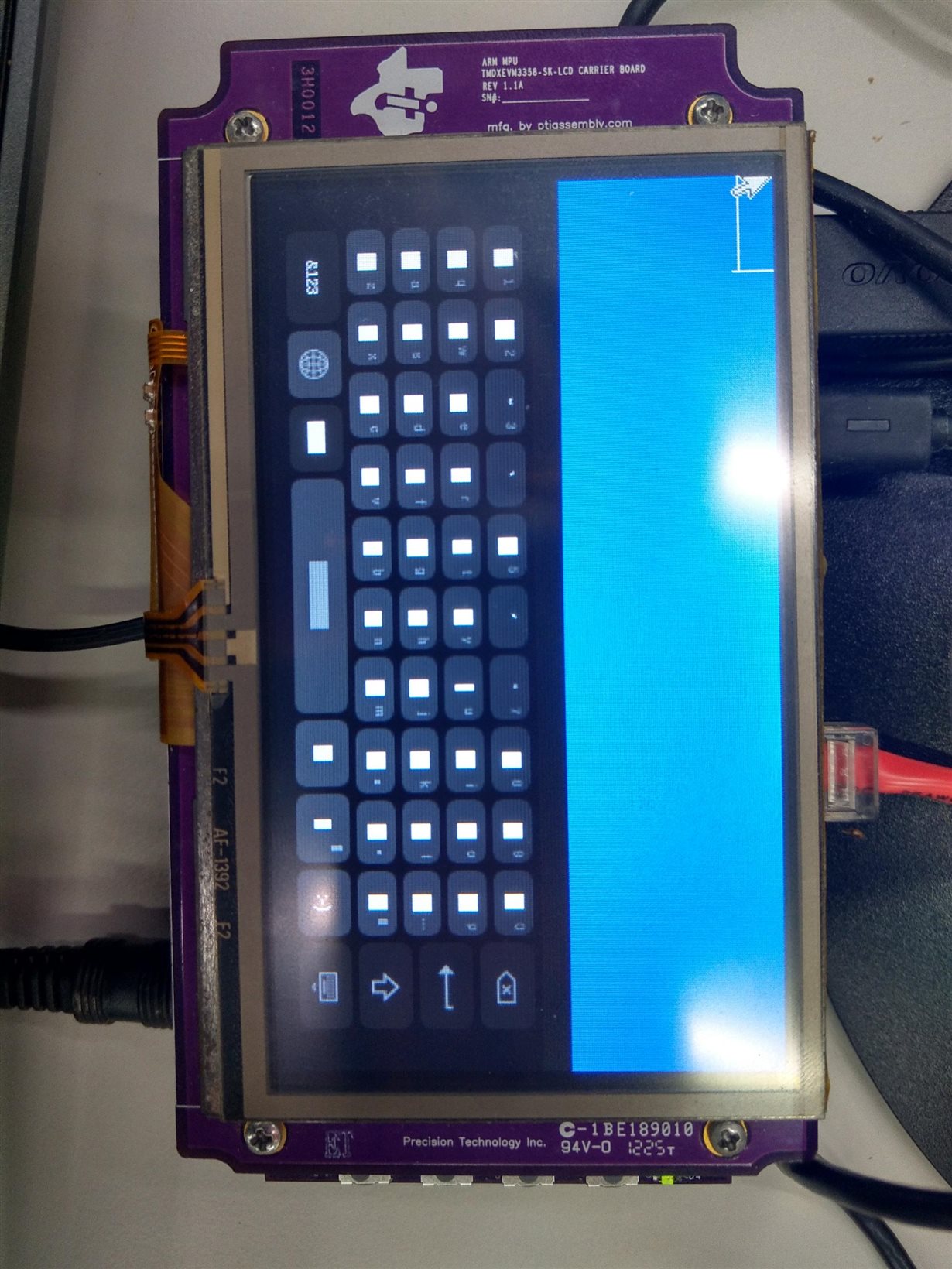

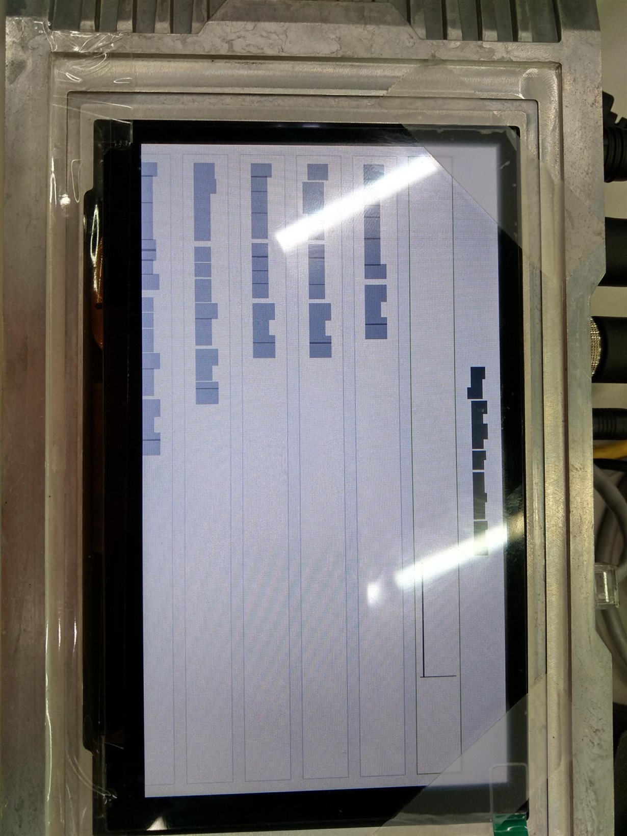

Virtual keyboard is malfunctioning on AM335X (the problem of disappearing text)
CPU: AM3354
SDK: ti-processor-sdk-linux-am335x-evm-06.00.00.07
Qt Version :5.11.3
image:tisdk-rootfs-image-am335x-evm.tar.xz
QT platform eglfs
When using the virtual keyboard function, I have been inputting simplified Chinese or traditional Chinese characters, and the text disappears.
Can you provide assistance and advice?
root@am335x-evm:~/nfs/qtvirtualkeyboard/examples/virtualkeyboard/basic# ./basic
Unable to query physical screen size, defaulting to 100 dpi.
To override, set QT_QPA_EGLFS_PHYSICAL_WIDTH and QT_QPA_EGLFS_PHYSICAL_HEIGHT (in millimeters).

               I tried the AM335x start kit platform, and used ti-processor-sdk-linux-am335x-evm-06.00.00.07 without modifying the SDK.
    Because We need Chinese to be displayed, so  I only put it in /usr/share/fonts/ttf/FZLTHNokiaSans.ttf in the filesystem
    The same problem occurs in eglfs.
    When I used Wayland/Linuxfb to test, because of the desktop test error message, I could not use the original tst_inputpanel to test.
    But we also found something, if I set
    export QML_DISABLE_DISTANCEFIELD=1
    or
    export QT_QUICK_BACKEND=software
    It seems to solve the current problem. However, the display of fonts is not good.
    I think it has something to do with display acceleration.
    Oliver

    This problem has been solved!
    The current solution is qml view.setTextRenderType(QQuickWindow::TextRenderType::NativeTextRendering);
    It looks okay.
