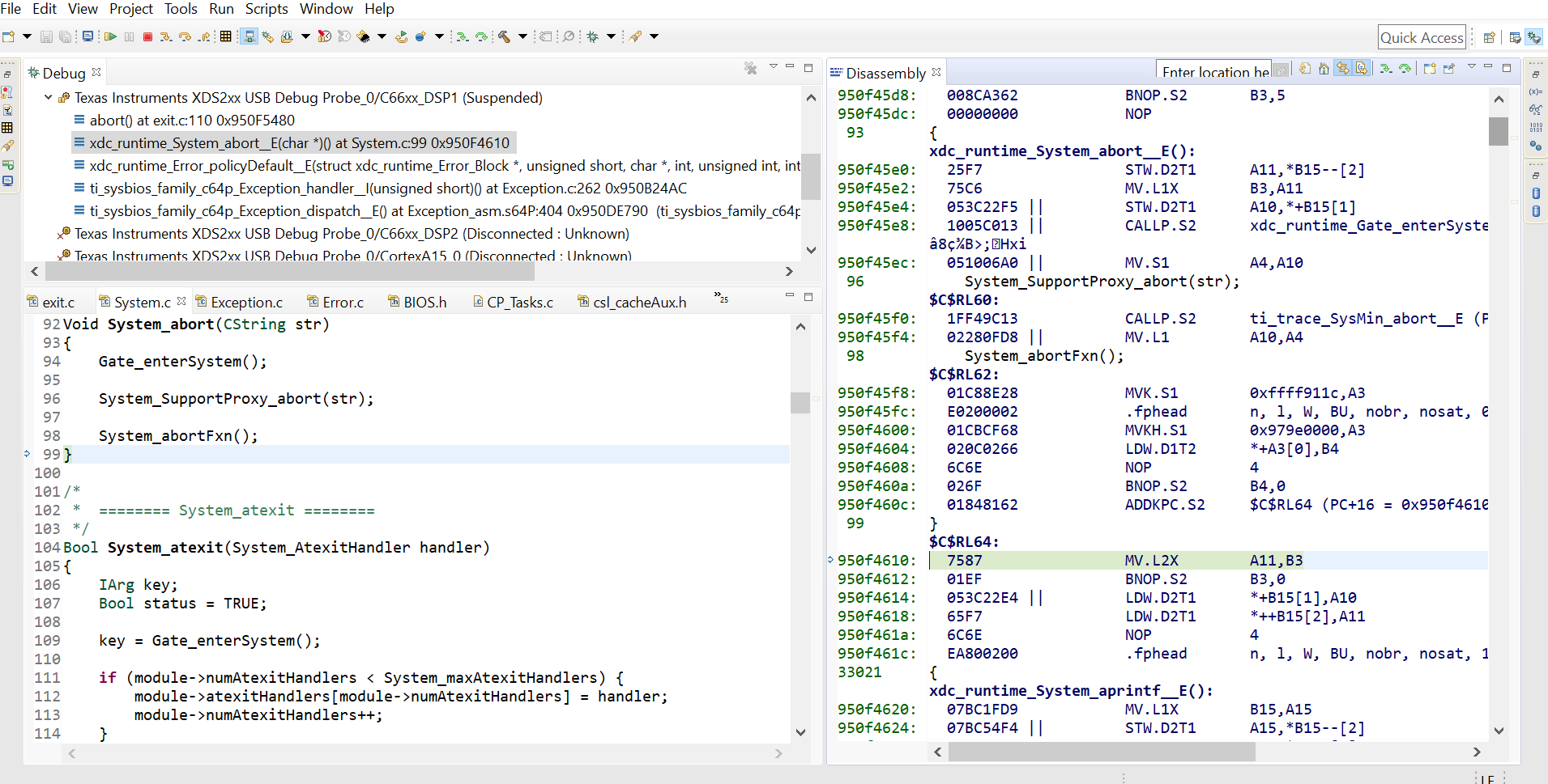

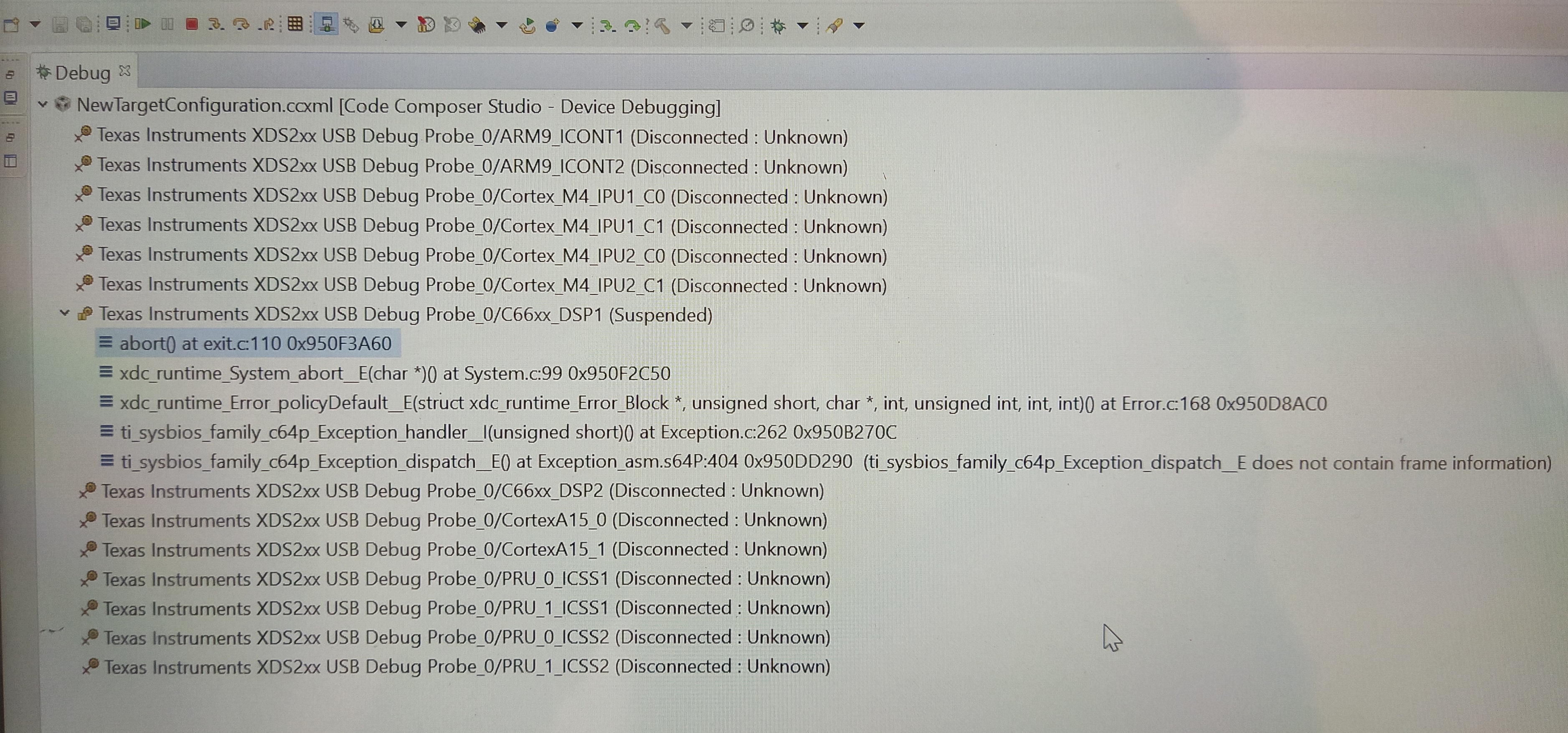

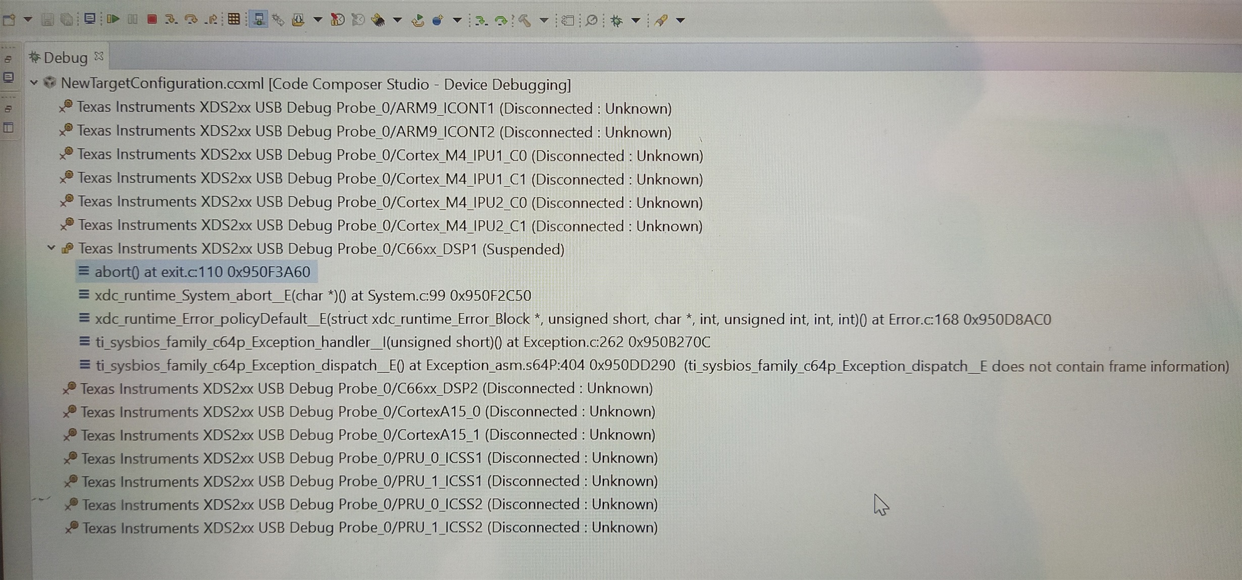

we tried o debug using jtag we are getting the call stack as below shown in the attached image.
And its hard to find out from which function we are getting this exception.
  • Please refer to Ch 6 for the detail description on DSP Exception.
    https://www.ti.com/lit/pdf/spru732
    You can try to set a breakpoint at the entry of ti_sysbios_family_c64p_Exception_dispatch_E() and dump the exception registers.
    NRP register should hold the return address which is where the exception occurred.
    Stanley
  • Hi thanks for the response.
    We have captured the register dump on console as shown below that NRP contains the value zero at the time of exception.

  • This is the disassembly code at the time of exception as in call stack it is showing.
