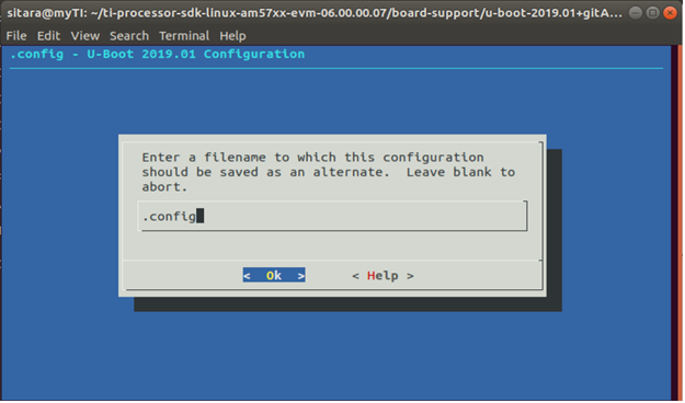

  • Hi Vishal
    I have configured u-boot parameters in host linux as follows with CONFIG_IS_IN_FAT disabled  and  CONFIG_IS_IN_MMC enabled:
    sitara@myTI:~/ti-processor-sdk-linux-am57xx-evm-06.00.00.07/board-support/u-boot-2019.01+gitAUTOINC+8b90adfb16-g8b90adfb16$ make menuconfig
    the I saved configuration in file  .config  as:
    then I make u-boot files as :
    sitara@myTI:~/ti-processor-sdk-linux-am57xx-evm-06.00.00.07/board-support/u-boot-2019.01+gitAUTOINC+8b90adfb16-g8b90adfb16$ cd ..

    then I copied the files  MLO and u-boot.img  into   /run/media/mmcblk1p1  (boot partition of eMMC in EVM).
    after reboot, previous warning (bad CRC) and reading Environment from FAT is prompted.
    should I do any other thing that may I forget it?
    BR,
    Ali
  • Hi Ali,
    The images you attached in previous response didn't come through.
    After you did menuconfig, did the .config reflect CONFIG_ENV_IN_FAT as disabled?
    Vishal
