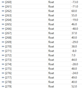

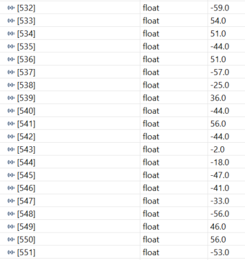

I have some trouble with decoding packets with the TCP3D. Im using it in LTE-Mode with in single buffered mode with Blocklen k = 1088.
Around the subblock-borders (LTE-Mode is 4 subblocks => 1088/4 = 272), 272, 544, 816 the Softbits values are dropping and even bits flipping.
Is this a known problem or could this be a configuration problem, like wrong calculation of beta values?
