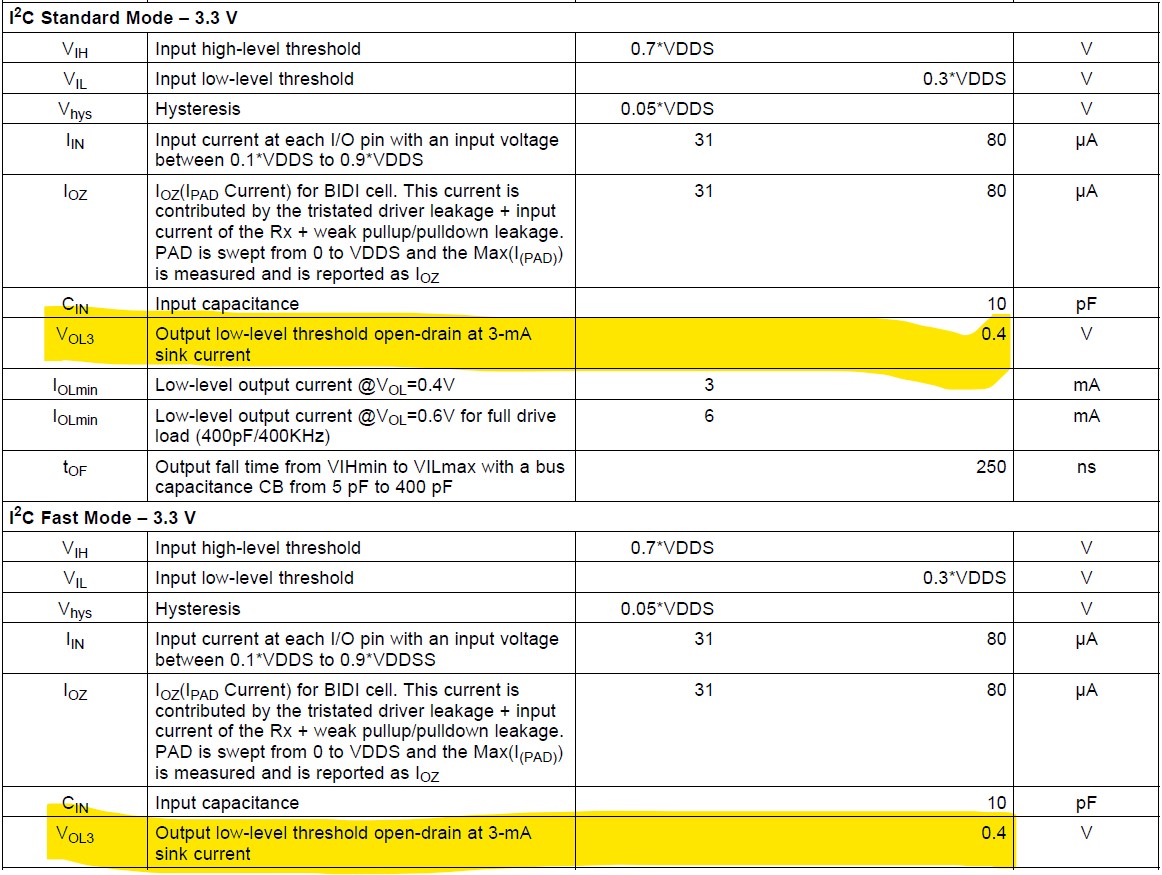

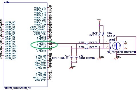

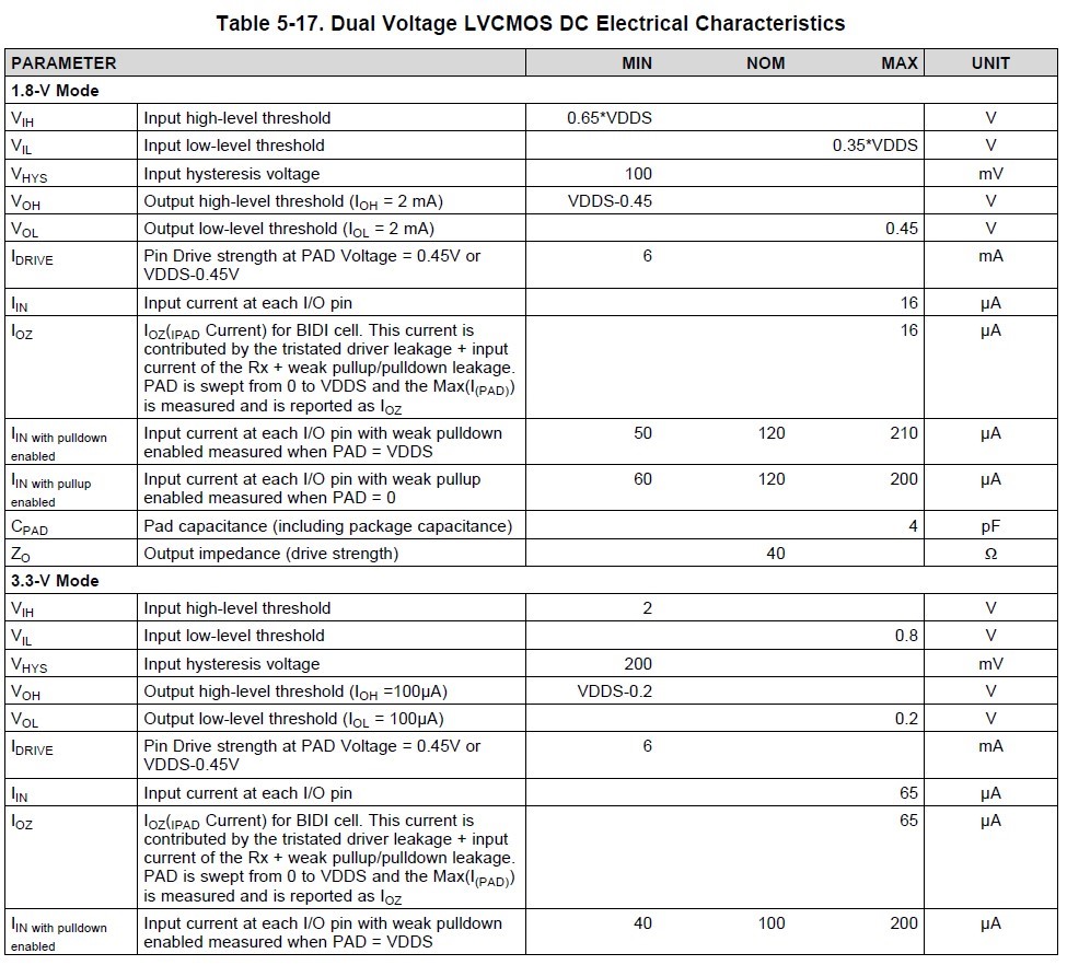

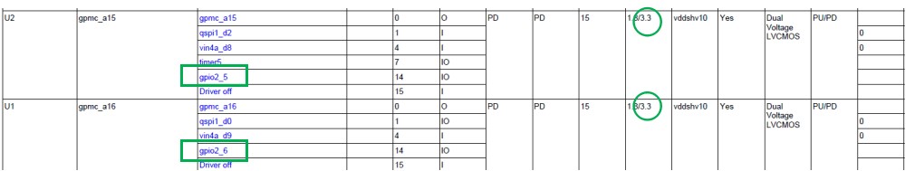

My customer check the AM5728 spec,the spec have data for IO Pull Up and Pull Down Sink Current, but he can't find out Sink Current when U1 and U2  are Open Drian.
AM5728 spec only have data for I2C Open Drain IO Sink Current.
