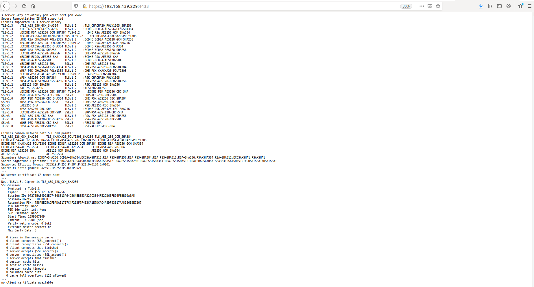

  • Secure Web Server
  • openssl s_server -key privatekey.pem -cert cert.pem -www &
ACCEPTED
  • But on opening in browser
https://IP:4433
