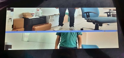

i have some difficulties when trying to stream video over HDMI on display with 1920x720 resolution. I have changed display parameters for 1920x720 resolution and set timing parameters on HDMI interface. However, the display does not work as expected.  I can see the image, it does not move but there is a horizontal line on display which split the image. It is shown on picture below.
I also notice that the position of this line depends of a moment when streaming video is started (or HDMI is plugged in), precisely when i unplugge the HDMI connector while video is streaming, and plug it in again the position of this line changed every time. I'am confused about that. I note that display works just fine when connected to a PC (both Windows and Linux). I also note that HDMI signals are converted to LVDS using TFP401APZP and transmitted using DS90C385AMT.
I suspect this to be an issue with synchronization and that this line is blanking time. Does somebody have this or a similar problem? What has caused this line? I am not sure do i need some aditional configurations.

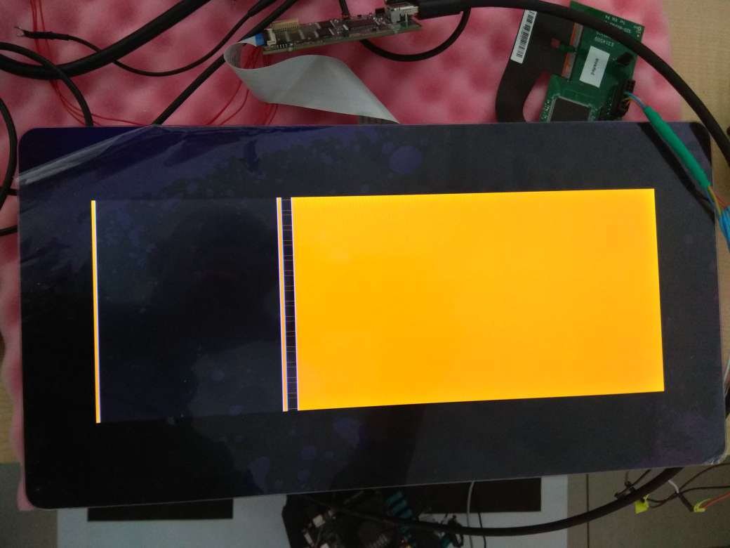

  • Hi Brijesh,
    When I say perfect timing, I mean the one I see on oscilloscope (signals output from TFP401A to LCD panel). The signals match the one from PC (when display works correctly).
    The display shows some artificial image (half orange, half black) and it is not split screen (at least not horizontally). There is a vertical boundary between black and orange area, however. I do not think it is related to synchronization but rather incorrect data streamed via HDMI.
    Mladen

    Also, I am providing you with the image on the display when we change DE polarity (parameters of internal HDMI on TDA2Px), which I discussed before.
  • Hi Mladen,
    ok understood, the output is expected, because if you change polarity of DE, it might display even blanking data. So i would suggest keeping DE inverted.
    If DE is inverted, what do you see in output? Please note that DE will toggle only during active video duration. If this is not expected, then output will not be correct.

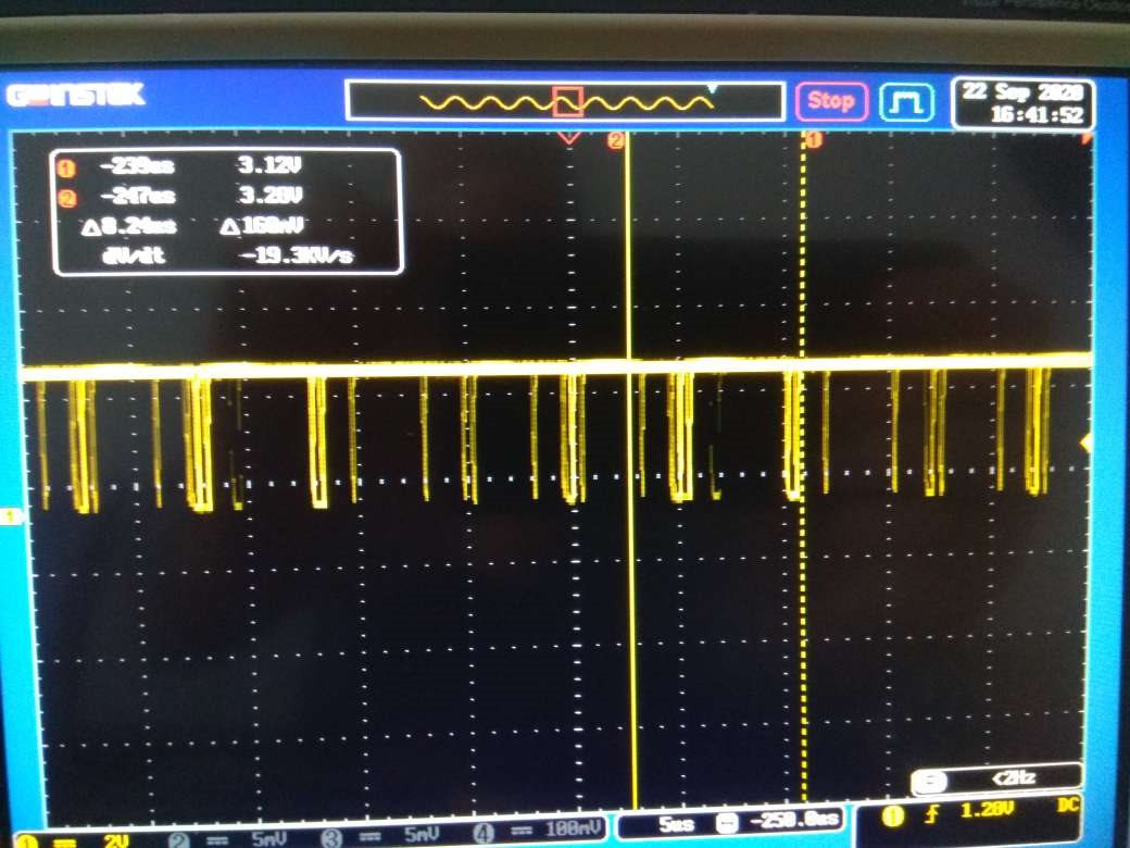

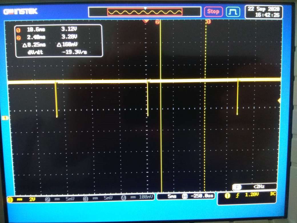

  • I also attach the previously discussed observations captured by oscilloscope (when default DE polarity is used).
    DE signal (with zoomed toggle region):
    VSYNC signal:
    As I mentioned, HSYNC shows no action, i.e. it is always high.

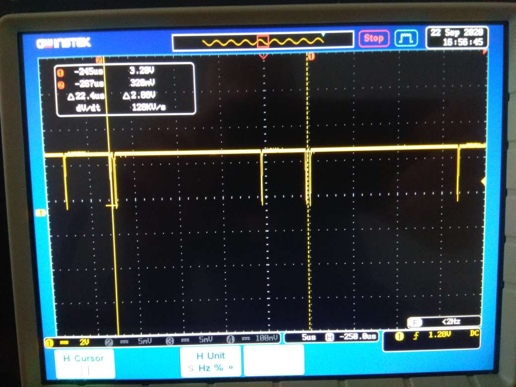

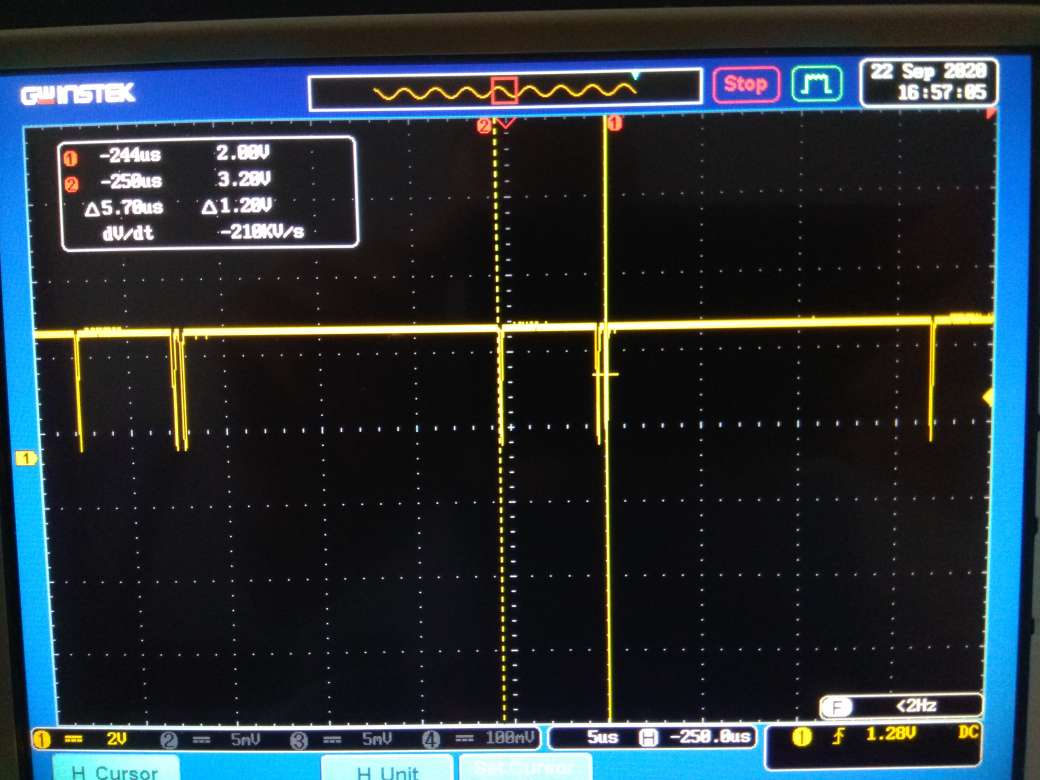

  • Finally, here are some waveforms when aliased traces are removed.
    First image shows the total duration of DE signal (as can be seen it takes about 22-23us). The second image is (almost) the same and it corresponds to the duration of blanking interval (about 5-6us). The timing seems to be in line with what we expect, however, the integrity of the signal is compromised. It looks like something force DE to go high even during the blanking interval. It is like there is some mix-up between the signals.
    Mladen
