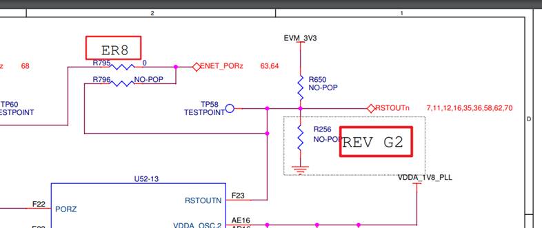

Hi Team,
May I ask a simply question about SCH?
There are some ER8 and REV G3 labels in the schematic diagram of J6. Do these labels have any special meaning?
https://www.ti.com/lit/df/sprr210/sprr210.pdf?ts=1599546624028&ref_url=https%253A%252F%252Fwww.ti.com%252Ftool%252FJ6EVM5777
  • The labels are used to track changes as the design progressed.  Rev G2 label was to time-track when a specific change was made (like not populating the R256 resistor).  ER8 is similar, used to track change requests (like changing the population options between R795 and R796.  The schematic includes a change log which summarizes all the changes.
