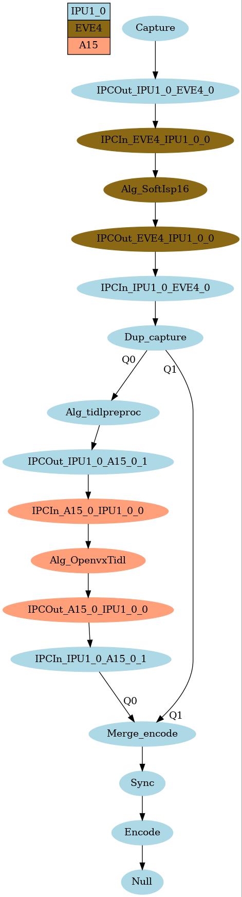

Hi all,
I am using VSDK 0308 and trying to incorporate tidl_openvx into my custom usecase.
My usecase is as follows.  Alg_SoftIsp16 is a custom eve application that implements Bayer->RGB->UYVY->NV12 conversion and is tested as working in my system.
I am trying to figure out the most streamlined way of returning the data to NV12 after the TIDL link which I believe is adding additional OpenVX stages to run the color convert to pass the correctly formatted data to the Encoder but I am having a hard time deciphering how to make changes to the graph after the TIDL plugin has added the TIDL nodes within openvxTidl.c.  I have no prior experience with OpenVX or TIDL so this is definitely a learning experience.  Any guidance would be much appreciated!
Joe
  • Forgot to include my run log.  I also didn't mention that the TIDL node is completely unmodified.  I copied the params over directly from the chains_tidlOpenVx_OC.c though I'll be switching to the OD mode after I get this working.  Below is my params config.
        /* YUV420SP to planar RGB conversion */
        pUcObj->Alg_tidlpreprocPrm.outPad = 4;
        pUcObj->Alg_tidlpreprocPrm.numOutputQueues = 1;
        pUcObj->Alg_tidlpreprocPrm.procMode = TIDLPREPROC_LINK_PROCMODE_Y2R;
        /* OpenVx TIDl Params */
        pUcObj->Alg_OpenvxTidlPrm.eveCoreIndex = 1;
        pUcObj->Alg_OpenvxTidlPrm.operationMode = TIDL_OC;
    //    pUcObj->Alg_OpenvxTidlPrm.grpxSrcLinkID = pUcObj->GrpxSrcLinkID;
        pUcObj->Alg_OpenvxTidlPrm.grpxSrcLinkID = -1;
    //    pUcObj->Alg_OpenvxTidlPrm.nullSrcFramePeriodicity = pUcObj->NullSourcePrm.timerPeriodMilliSecs;
        pUcObj->Alg_OpenvxTidlPrm.nullSrcFramePeriodicity = -1;
        pUcObj->Alg_OpenvxTidlPrm.posX = 50;
        pUcObj->Alg_OpenvxTidlPrm.posY = INPUT_HEIGHT + 200;
        strncpy(pUcObj->Alg_OpenvxTidlPrm.tidl_params_file_path, "/home/root/tidl_param_imagenet_jacintonet11v2.bin", 256);
        strncpy(pUcObj->Alg_OpenvxTidlPrm.tidl_network_file_path, "/home/root/tidl_net_imagenet_jacintonet11v2.bin", 256);

    Have you set pLinkChPrm->format params?
    Please take a reference of encoder link params from the below usecase file.
    vision_sdk\apps\src\rtos\usecases\vip_single_cam_view_encdec\chains_vipSingleCam_EncDec_Display.c
    in your use-case, you are trying to encode 2CH of data, one is the output of OpenVXTIDL and another is the output of Softisp16. So do you want to encode both the channel?
    Make sure the input data format to the Encode link is NV12 or not.
    Gaviraju
  • Hi Gaviraju,
    Thanks for the response.  I am looking to pass a single channel of the processed output from the TIDL link with what I assume will be bounding boxes and object classifications/detections.  I'll modify my usecase to remove the channel coming from the isp link.  That leaves the second question of how to return the data back to NV12 from the openvxtidl link.  Can you guide me on modifying the openvx link to return the processed data to NV12?  I am reading through the tutorials and user guides of openvx and am not seeing how to add the extra steps to the graph to convert the data to NV12.
    I THINK that change should occur in apps/src/hlos/adas/src/alg_plugins/openvxTidl/openvxTidl.c around line 1453 but, as I mentioned, I am new to openvx AND tidl(and deep learning in general) so I am having a hard time figuring out what nodes/kernels are already present in the graph.
    I have made these modifications to the usecase but my output is unchanged.
    Joe
    The O/P buffer type of the Alg_OpenvxTidl link is "SYSTEM_BUFFER_TYPE_METADATA", so it's not possible to add an Encode link after the Alg_OpenvxTidl link because the Encode link expecting "SYSTEM_BUFFER_TYPE_VIDEO_FRAME" I/P buffer type.
    We recommend creating the following use-case.
    After creating the above chain, make sure the links parameter settings in the use-case file.
    Gaviraju

  • Hi Goviraju,
    Thank you for the response.  I am currently in the processing of testing your changes and I am still not having any luck.
    As a preface, Capture->Alg_SoftIsp16 (EVE4) -> Encode -> Null  works great at 30 FPS.  A few strange things do occur though:  Adding in the Object Detection, SOF, etc will drop the FPS output of Soft_Isp16 to less than 5.  It lists this FPS drop in the performance statistics of Soft_Isp16 despite none of the cores being fully utilized.  I will attach a log.
    I had to make a few changes which I think is because your usecase appears to be RTOS based while mine is Linux based.
    1) Add Alg_ObjectDraw=yes to my usecase cfg.mk
    2) iop_ti.h is not part of this usecase's include path so I commented it out and added #define TIDL_MAX_PAD_SIZE (4) to my chains_gm_test.c.  It doesn't appear any other parts of iop_ti.h are required.
    3) Alg_OpenvxTidl has this output when executed on the ipu:

    4) Update the usecase to the following to put Alg_OpenvxTidl on the A15:
    I am also attaching my algorithm plugin for vsdk and the associated EVE library containing the soft_isp16 application.
    Looking through the debug log, it looks like somehow as the data is passed, the pitch at the encoder is being detected incorrectly.  I'm looking through the code to see if I can track down where that issue is occurring.
    Joe

    >> As you mentioned The chain : Capture->Alg_SoftIsp16 (EVE4) -> Encode -> Null works great at 30 FPS
    This indicates there is no issue in the Alg_SoftIsp16 Algorithm.
    This is the expected O/P because The Alg_OpenVX algorithm will take around 230ms to process one frame. So the total FPS is supported in a chain is
    FPS = (1000 ms) / (Maximum Time is taken by the link in the chain)
    FPS = 1000ms/ 230ms
    FPS = 4
    >> [HOST] [IPU1-0] 41.769779 s: Network file size is different than sTIDL_Network_t structure size !
    Can you share the network file used in the use case? need to check the size of the file.
    Please share the O/P of make -s showconfig

  • Hi Gaviraju,
    In my last post, I hadn't posted a new usecase.  I have tested a few different tweaks to the usecase in an effort to see what is and isn't working but, with regards to our discussion, I have been keeping it functionally close as I can to your RTOS usecase with the exception of moving any required components to different cores for Linux.
    Anyway, here is my current usecase.
    Thanks!
    I ported the use-case from RTOS to HLOS, use this as reference & modify according to your use-case.
    tidl_od_openvx_linux.zip
    I/P files: Copy this file into the /opt/vision_sdk/ folder
    Inputfile.zip
    Gaviraju
