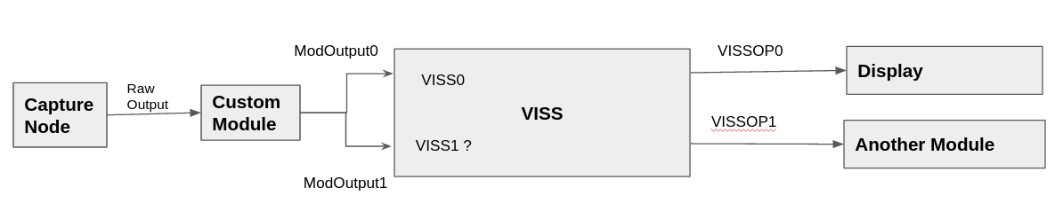

I have a use case where I need to take the output of capture node "tivxCaptureNode" and send it to a custom module. Depending on some condition, this module has to either bypass its input or do some processing on it and then output it. Basically, this module will give two different types of output (direct bypassed one or the processed one). Lets call these output as ModOutput0 and ModOutput1. These two outputs have to be processed separately by different instances of VISS (The VISS has to run with two different set of configurations internally since the image formats and tuning parameters are completely different).
                                                                                                                |----[ModOutput0]--------------------------->| VISS0                                  |------------[VISSOP0]-------> Display
Capture Node Output -----[RawOutput]------> Custom Module------    |-----[ModOutput1]--------------------------> |VISS1?             (VISS)         |-------------{VISSOP1]---|----> Another Module
1) I can create a vx_object_array of two elements(ModOutput0 and ModOutput1) and give it to VISS and call replicate node on it. The problem is the above two(ModOutput0 and ModOutput1) paths are not supposed to run in parallel  : at a time either ModOutpu0 is valid or ModOutput1 is valid(to be more precise alternate frames need to go to respective VISS). If I use replicate node, VISS will simultaneously process both the outputs which is not required.
2) How can I change the tuning parameters for each instance of VISS(VISS0 main node and VISS1 replicate node). Or should I create single instance of VISS(without replication), but change the configuration parameters of  VISS dynamically (In that case I wont have ModOutput0 & ModOutput1, instead a single ModOutput ) for the respective alternate frames ?
3) Since ModOutput1 is a direct bypass (this is equivalent to the camera Output [RawOutput]), is there any way I can avoid memcpy inside the Custom Module i.e. can I send output buffer of capture node to VISS?
Krishna
    The graph above is not coming proper. So attaching in image format.
    Krishna

  • Hi Brijesh,
    VISS0 has to work on RGB frames, whereas VISS1 will be working on monochrome frames.
    VISS0 will have following modules: BLC + NSF4 + WB + Demosaic + CCM + Gamma + YUV conversion + Defect pixel correction.
    Whereas VISS1 will have BLC + NSF4 + Gamma + YUV conversion + Defect pixel correction
    Krishna

  • Hi Brijesh,
    The gamma table will be same for both the cases.
    We prefer NSF4 configurations to be different for VISS1 and VISS2.
    However, in case we are not able to have completely different configurations, is it possible to have 'bypass' for VISS1 and 'enable' for VISS2?
    Krishna

  • Hi Krishna,
    If you are ok keeping gamma table same. it should be easier. Yes, we can disable NSF in instance and enable it in another.
    Essentially, create two VISS instances, one with DCC file and next without DCC file. In the second instance, somehow, we need to set nsf4Bypass flag to true.
    Now with this change, second VISS instances will reuse all tuning parameters from first instance and since nsf4 is bypassed, driver will take care of switching it off.
    Could you please try it out?
