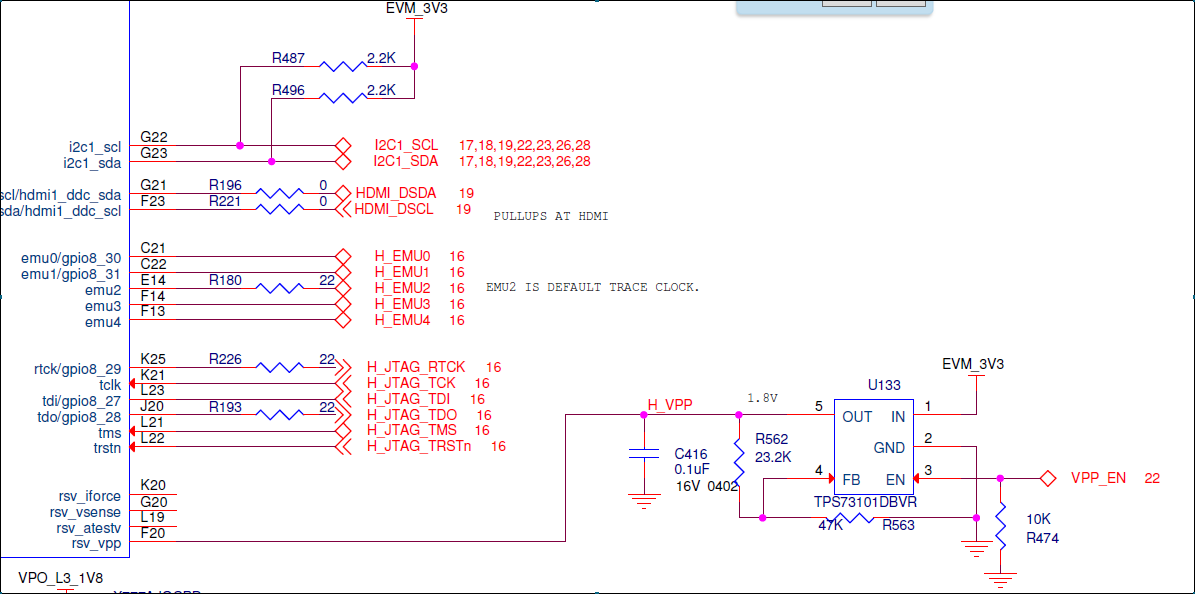

  • Hi Gaviraju,
    During this time, I carefully check the hardware electrical signals.As shown below
    Have the following problems:
    1、Measure I2C1_SCL and  I2C1_SDA voltages are both low,Normally it should be high.This causes the i2c command to read the LP87332DRHDRQ1 register after the sbl is started to fail.
    2、I don't know what the rvs pin does.No description of this pin was found in trm.The H_VPP voltage measured on my evm board is zero.Indicates that there is no work. Will this have any effect?
    3、I’ve been posting this thread for five days and haven’t got a definitive answer yet.This makes me unable to continue to develop on the linux system, and the rots system always prompts i2c read and write errors.
    I'm about to collapse, I need your help very much now.
    Thank you very much!

    1)I don't know what the rvs pin does.No description of this pin was found in trm.The H_VPP voltage measured on my evm board is zero.Indicates that there is no work.
    Please tell me the function of rvs pin?
    2)The i2c initialization failed because the power of the I2C1_SCL and I2C1_SDA pins has not been low at this time. Will it affect the Linux MLO startup?

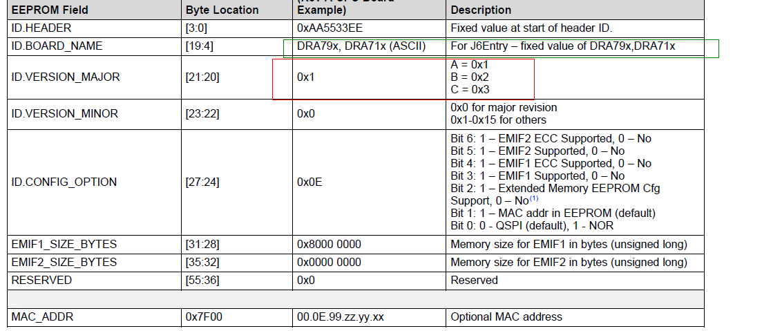

  • The EEPROM contents are defined in the EVM User's Guide, Section 3.6.25 Configuration EEPROM

    According to what you said, I have found Section 3.6.25 Configuration EEPROM, but I want to know the eeprom,
    Various possible values are listed here,But I want a certain value of the tda2ex17 evm board, please tell me?

  • I think the only change from what is documented in User Guide will be the revision.  This will likely be a 0x3.

    According to your answer, I checked "EVM User's Guide, Section 3.6.25 Configuration EEPROM" again.
    The screenshot of eerpom is as follows
    The 0x3 you gave refers to the field in the red box in the above figure, but I want to know the field content of the green box, which is on the tad2ex17-evm board.
    The ID.BOARD_NAME field is different, the program execution process is different.This is why I still need you to share the content of eeprom.

  • Hi Yanmm,
    The value 0x3 that Robert mentioned is for the Red Box.
    In the u-boot file I mentioned, look for configurations that are selected based on board_is_dra71x_evm() API and make them the default configuration.

  • Vishal and I have provided the answer.  Again - as specified in the User Guide, the ID.BOARD_NAME field is '‘DRA79x,DRA71x'

    The EEPROM is correct, the software also looks for same value. Please refer to board_is_dra71x_evm() API in u-boot code.

  • Additional detail, the API only tries to match eight characters from board name and not the entire name.
    #define board_is_dra71x_evm()           board_ti_is("DRA79x,D")
