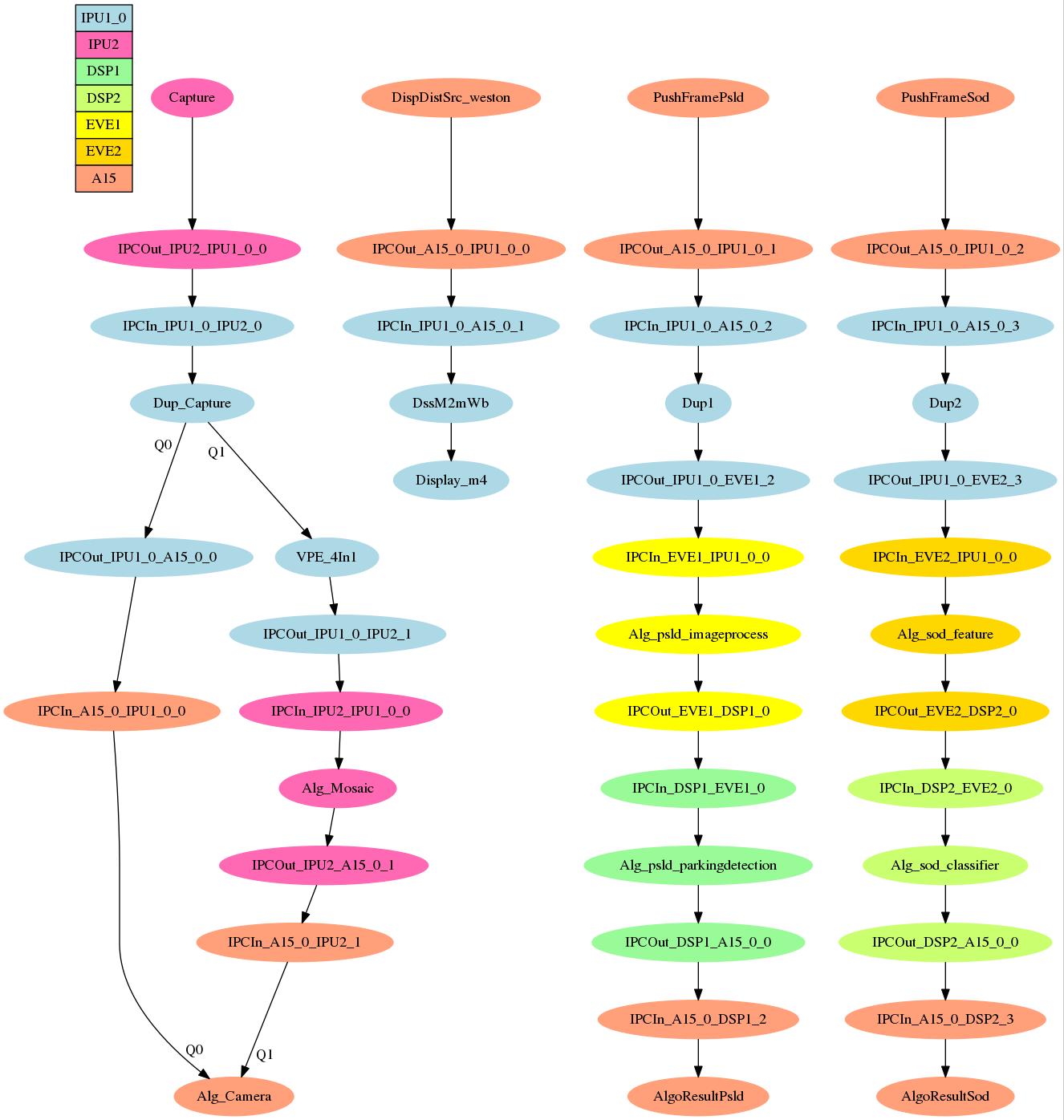

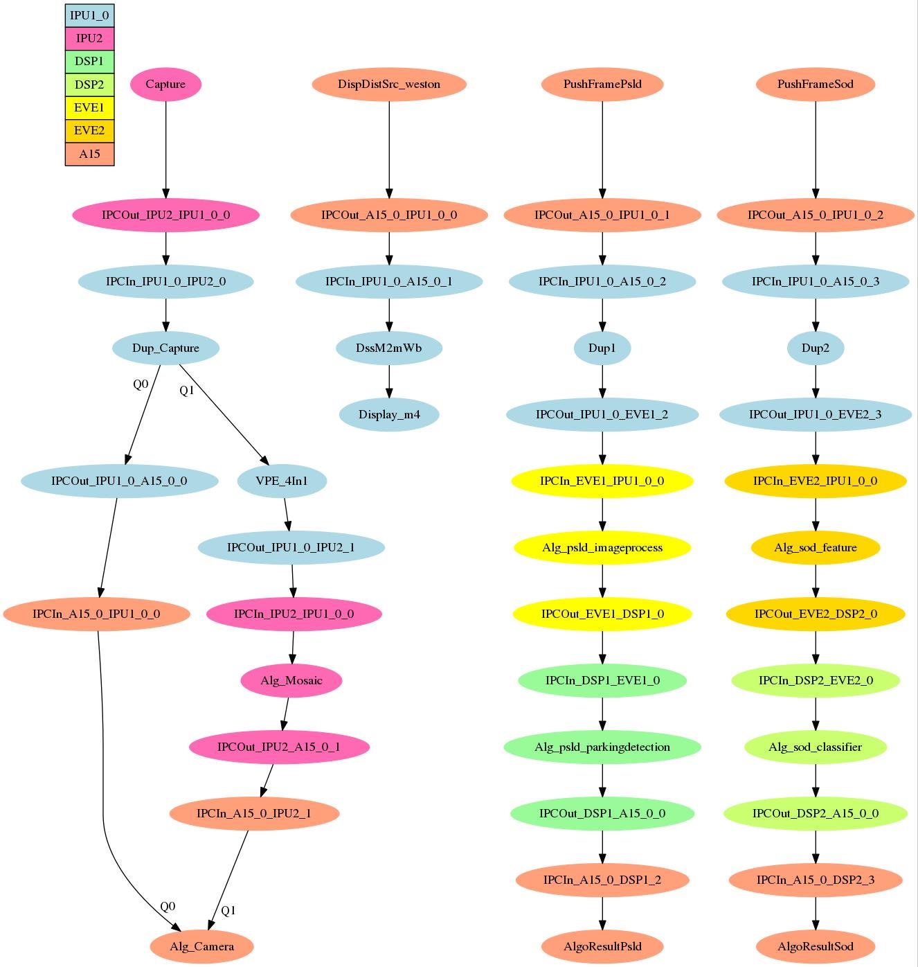

    The early use-case is : Capture -> Display_Video
    The late usecase is :  DispDistSrc_weston -> Display_m4
    In our demo, we modified the init-demo.sh script according to our requirements.

    Our use case is as follows:
     I want boot more fastly, But now we still need to load the remotecore to communicate normally, which will take up the startup time.
    Didn't earlyboot already start the M4 core?
    Why load the firmware and start it?
    We are not able to view the image can you attach it again?
    Gaviraju
    About Early boot & late attach refer to this link to modify https://processors.wiki.ti.com/index.php/Early_Boot_and_Late_Attach_in_Linux.
    Retransmit pictures and provide compressed package.
