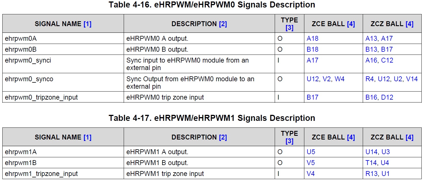

Customer want to design hw as belows:
1. ehrpwm0A control LCD backlight
2. ehrpwm0B control LED
3. ehrpwm1A control buzzer
Is it possible for this PWM design?
ehrpwm0A/ehrpwm0B/ehrpwm1A can independent control pwm ?
How to independent control pwm? change duty cycle?

    This use case seems acceptable at first glance.
    However, I do not know the requirements for the LCD Backlight, LED, and Buzzer control signals. The EHRPWM modules can actuate a PWM signal on either output (A or B).
    Please see Chapter 15: Pulse-Width Modulation Subsystem (PWMSS) of the AM335x Technical Reference Manual for a functional description of the EHRPWM module and details on its usage.
