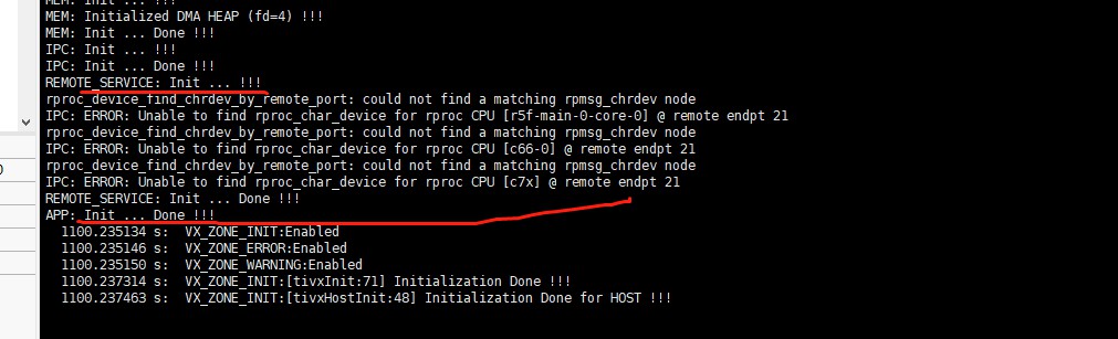

Hi Experts:
            because i don't use c66_1,so I
1, delete c66_1_fw in / lib / firmware,
2,on vision_apps\apps\basic_demos\app_tirtos\common\app_cfg.h,  not define ENABLE_IPC_c6x_1.
3,disabled the c66_1 node on kernel dtb.
when i run the  the encode test ,it printf below, but while then have c66_1_fw,it work ok.
my quesetion is:
1, All firmware is required for tda4 to function properly?
2, if it's not necessary, how to do?
3, if it's not necessary,why?
   thanks ! my sdk is 7.0
