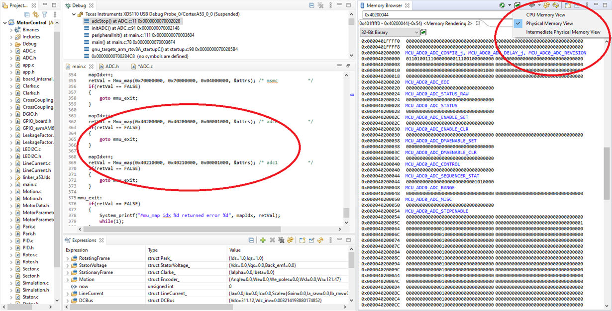

The below image is a screenshot of CCS. The top right red oval indicates a drop-down menu.
Question:
What is this?. What memory is this being associated with?
I have also indicated another oval to the bottom left, this is the RTOS "mapping".
At the risk of sounding completely daft, I'm assuming these drop-downs are related to virtual memory.
Question: If this is the case? Then where is the intermediate memory viewed from? What is this drop-down menu indicating/doing?.
Is this implying that the interconnect communication is implicitly happening by virtue that I have set up the RTOS function "Mmu_map" or do I need to set this up?
I am "writing" values to the ADC registers, but I am not completely convinced that I am. Sometimes I see it in CPU memory other times in physical memory, especially when single-stepping the software.

    You are correct that these memory view selections deal with virtual memory. The CPU memory view is the address seen by the CPU before translation and the physical memory view is at the memory (untranslated). Intermediate memory view shows the intermediate translation. The Arm MMU is a 2-stage lookup with stage 1 converting from CPU to intermediate and stage 2 converting from intermediate to physical. This allows for multiple OSs and hypervisor to run on the architecture, with the hypervisor controlling the second stage translation.
    Are you using the mmu_map to translate the address or only to set attributes?
    The MMU doesn't store the data, so your writes should propagate through unless they are landing directly in cache (if set as a cacheable region), in which case they may not be reflected at the physical memory.

  • Can you show us the line from InitMmu where you map the ADC?
  • Carl,
    Please do confirm. If you're setting an MMU section for control registers you'll want to be sure they're not cacheable. Address translation is likewise not required, and for basic applications your vaddress and paddress can be the same.
    e.g. below for config MMR entry and MSMC SRAM entry

    I can confirm that I have been setting the "attrs.attrIndx = 7"
    The domain is MCU  so I will change it to 0.

    Setting the memory attribute index to 0 would be the right thing to do, but this has nothing to do with your target peripheral being in the MCU domain (as opposed to MAIN domain, if that's what you're thinking of).
    The important information is in the comments from Dave's code snippets:
    attrs.attrIndx = 0; //non-gathering, non-reordering and no early write acknowledegement
    attrs.attrIndx = 7; // normal outer and inner write-back cacheable non-transient memory
    TI-RTOS / SYS-BIOS configures the A53 in a way so that memory attribute index (MAI) 0 has non-gathering, non-reordering, no early-write-acknowledge (nGnRnE) behaviour. On previous ARM architectures this used to be called "strongly ordered". The memory system ensures that every access performed by the CPU appears in exactly the same order and width on the bus, and it waits even for a write to complete (writing could also be "fire and forget").
    MAI 7 on the other hand is configured as "normal" memory, that is GRE: gathering, reordering, early-write-ack, and in addition the memory is marked as outer and inner write-back cacheable. The memory system is basically allowed to use all available optimizations to improve throughput.
    For peripheral registers, no matter which AM6x device domain they live in, you need to know that the access happen in the exact order etc., so you'd use MAI 0.
    The available MAI indices are defined by the operating system (TI-RTOS) in your case. You can find this in the installed SDK at .../ti/bios_6_82_01_19/docs/cdoc/ti/sysbios/family/arm/v8a/Mmu.html#.M.A.I.R0
