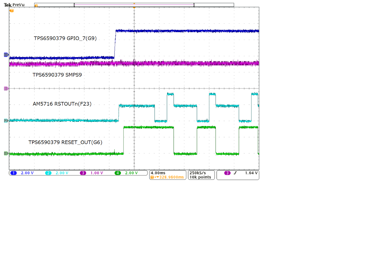

I am making a board similar to the MDXIDK5718 and checking the operation, but AM5716 and TPS6590379 reset alternately as shown in the attached figure, and AM5716 does not start.
Could you give me some advice as I do not know the cause? Also, is the assumed RSTOUTn waveform of AM5716 shown in the attached figure?
I've been asking a lot of questions on the power management forum, but I didn't find any issues with TPS6590379, so I'd like to know if there's anything wrong with AM5716.

    The rstoutn of the processor will be asserted if any hardware or software reset occurs.  Can you also show the waveform for the porz and resetn inputs to the SoC?
    Is the boot operation beginning prior to the 1st time the rstoutn is asserted?  Can you check that the boot interface is wiggling?  If boot is failing for whatever reason then software may reset the device via a software warm reset (which would also cause rstoutn to assert).

    The circuit I created is based on the basic evaluation board (TMDXIDK5718), and the TPS6590379 RESET_OUT (G6) in the attached photo and the AND of pushSW are input to Porz of AM5716.
    The resetn waveform cannot be taken immediately, but the resetn was constant at 3.3V.

  • Keisuke,
    This will occur if you have a pullup on the AM57xx's RSTOUTn signal.  There is a note about this in the schematic checklist:
    If you are using the PMIC feature to workaround errata i862, make sure you do not have a
    pullup on RSTOUTn as it will cause an infinite reboot loop.
    The RSTOUTn signal is a push-pull signal, so you do not need a pullup on it like you would for an open drain output.  Once you remove the pullup this issue will be resolved.

  • Keisuke,
    I have seen this issue many times, and it is always due to a pullup on RSTOUTn.  Is there perhaps a device connected to RSTOUTn that has an internal pullup?  As a test, can you add an external pulldown somewhere on that net?

    Upon investigation, there was a pull-up on the DP83867 to which RSTOUT was connected. It was improved by putting a pull-down.
