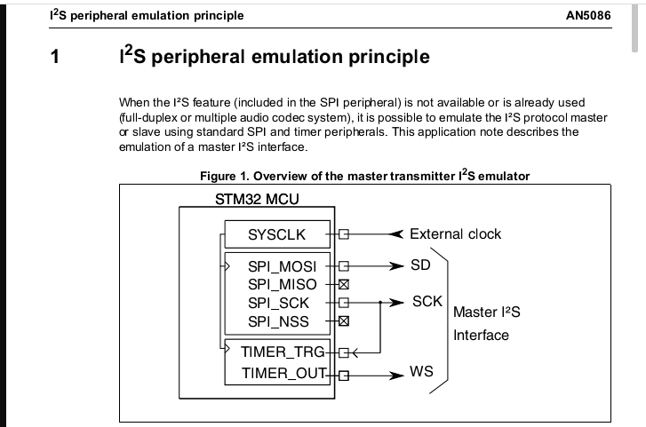

Dear Sir,
I am sending the audio data from ATSAMD21J18A to TLV320DAC3100. This communication is working perfectly fine.
Now I have to integrate the ATSAMD21J18A with the TI processor AM3358. AM3358 will send the audio data over SPI to
the ATSAMD21J18A microcontroller.
I2S clocks are running at
MCLK 11.2896MHz
SCLK 2.8224MHz
WCLK 44.1KHz
Please recommend suitable baud rate for this SPI transmission.
I am attaching here the waveform I have captured using oscilloscope for the SPI and I2S clocks as well as the block diagram for the audio section that I am trying to implement.
Let me know your feedback and recommendations.
Looking forward!
Upendra Kumar

  • Hi Krunal,
    I'm using  AM3358 beagle-bone green wireless (ubuntu), our requirement are sending audio data from  AM3358 to TLV320DAC3100, but I2S Lines busy with Bluetooth Module.
    So my question is can we emulate i2s(software-i2s) over SPI lines?
    if possible then could you share the example code for reference.
    I'm sharing the attachment  for your reference.
    Thanks & Regards
    Upendra Kumar

  • Hi Krunal,
    I'm sending two bytes of data (0x55,0xAA), then receiving that data in slave side, there are not loosing any data but we are sending more than 300kByte of data, that time I can not able to observed the data loosed  are not, but the SPI clock speed should be at 2.8 MHz. In MCU side receiving the data then immediately sending that data over I2S.
    It's more challenging to handle the audio data from SPI to I2S, So may be our data have loosed.
    I have some doubt.
    1. Is any tools are available to configured SPI in user space like TI System Configuration Tool for PIN Mux.
    2. Is it possible to send audio data over SPI to TLV320DAC3100.
    3. there are two MCASP are available. one MCASP line busy with Bluetooth Line. Is possible to use another MCASP to transmit audio data.
    according to AM3358 beagle-bone green wireless Schematic they are not providing that line to outside. my hardware team have to identify this issue.
    may be we are wrong.
    there are any possibility to used Both MCASP Protocols, if possible Please share the example code.
    Thanks and Regards
    Upendra Kumar
  • Hi Upendra,
    1. We will get back to you on the SPI configuration.
    2. We do not have any out of box examples or documents that demonstrates how to send I2S data over SPI.
    3. It is possible to configure the McASP to transfer audio audio data to TLV320. I would recommend you to please review the following threads.
     a. https://e2e.ti.com/support/processors/f/791/p/921547/3410050#3410050
     b. https://e2e.ti.com/support/processors/f/791/p/936823/3463007#3463007
    Krunal
