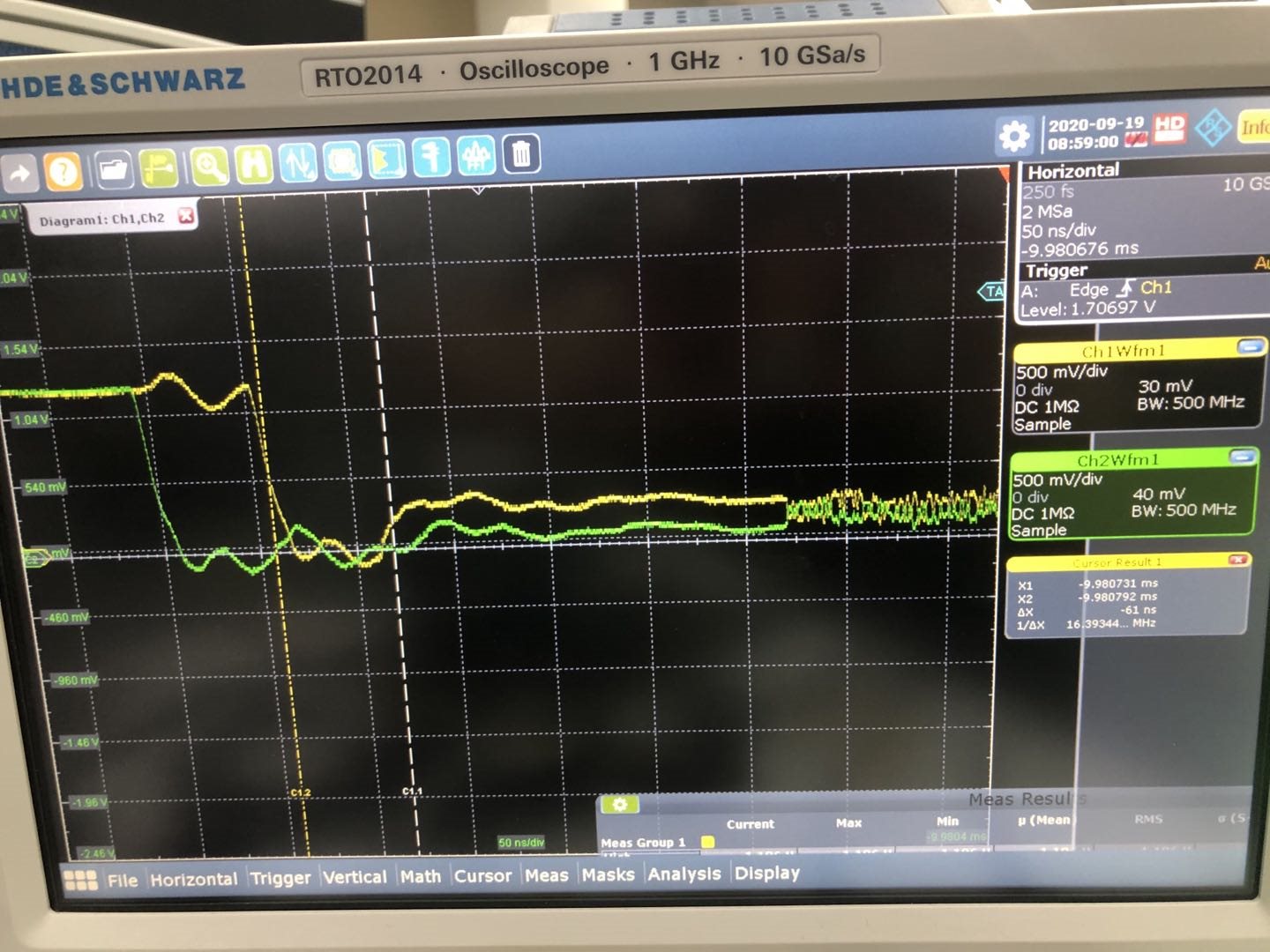

  • Hi Brijesh,
    1, are you setting lane position and polarity correctly?
    yes, i have check the schematic and use oscilloscope to check the signal.
    2, are you setting up lane speed correctly?
    I think so, just setting the speed by the following code:  "captureObj->params.instCfg[id].laneBandSpeed = TIVX_CAPTURE_LANE_BAND_SPEED_880_TO_1040_MBPS;"
    3, is the data type and virtual channel setup correctly?
    I think so, i have set the VC and DT in the deseriser.
    I have noticed that there exists some register in deseriser to seting the HS-perpare, HS-Zero ,Tlps, HS-sync etc, are those paramters matter for the DPHY in TDA4VM to recevie the CSI signal?
    Hutian

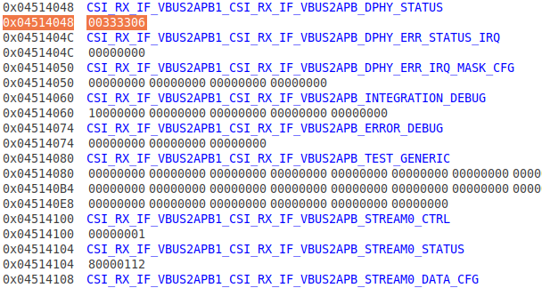

  • Hi Brijesh,
    I use the the default setting,but TDA4VM's status register of CSI_RX stream 0 alway's runing at the " PROT_WAIT_CTRL". The following picture shows the data of the register.
    Could you please check with your colleague about the parameters if it is convenient for you?
    Many thanks,
    Hutian
  • Hi Hutian,
    Could you please continuously refresh memory window and see if value at VBUS2APB_DPHY_STATUS status register is changing?
    If it is changing, atleast, PHY is able to detect status on individual lanes. Then please check the virtual channel id and data type. It should match with the incoming data.
    Brijesh
  • Hi Brijesh,
    As you can see the below picture, the VBUS2APB_DPHY_STATUS status register is changing between two status: 0x00333306 and 0x00222206.
    1. If the DPHY is able to detect status on individual lanes, which means the parameters (HS_prepare, HS_Zero ...) setting correctly and i don't need to change it?
    2. How to check the virtual channel id and data type in TDA4 ,or only available in deserilzer side?
