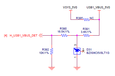

For the first time, both voltages of USB0_VBUS and USB1_VBUS were scaled down from 5V to 2V using the circuit in "7.3.3 USB VBUS Design Guidelines in the data sheet.
However, USB0 worked well, but USB1 got disconnected with 2V frequently about 200ms after the connection.
I changed a resistor and scaled up the voltage from 2V to 3.2V. It works well now.

    What resistor values are you using?  The divider network shown in section 7.3.3 of the data manual, when implemented with the resistor values given, will cause the USBn_VBUS pin to detect connection for a (pre-division) VBUS value between 4.2V and 5.5V.  Your comment on "scaling down voltage from 5V to 2V" suggests different resistor values.

    The divider network on my board is the same as the section 7.3.3. I attached a part of our schematic. You can see the same resistors and lines.
    I meant that this circuit reduced the voltage from 5v to 2v.
    => 5V X (10K / (10K+16.5K+3.4K)) = 1.7V

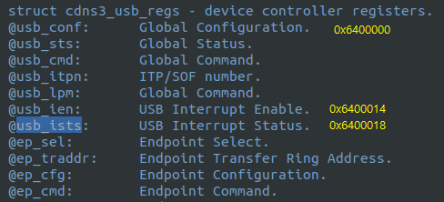

    Isn't 0x6400014 "USB Interrupt Enable register"? Don't you want to know "USB Interrupt Status register"(0x6400018)?
    I don't have the memory map for the register. I guessed them through the structure in gadget.h

    I'm not sure how gadget.h is set up and how it translates to the USB registers.  However, the register at offset 0x14 contains status fields related to VBUS detection and OTG operation that could help us see what's going on.  According to the Main memory map in the TRM for this device, the base address are at 0x6000000 and 0x6400000:
    Could you provide a register dump of these memory ranges?  If not, just the registers I mentioned will be enough to get started.  I'd like to see it before and after connection with both voltage settigns (3.2V and 2V).
