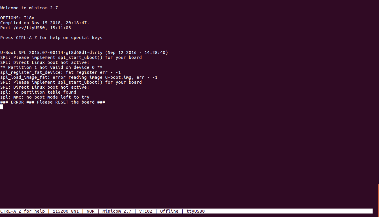

Here i have a custom board with am437x i created a sd card image and wrote in to sd card and booted normally it booted expecting input device at first time i given mouse first and later modified weston.ini file ok working fine. suddenly today morning it is not accepting any sd cards it is not booting with any sd cards for some old sd cards it is showing u-boot version date  that's it nothing is coming on console. and nothing is displaying on display. what might happened any body have idea of nothing is displaying on console and display as well. i checked hardware all cables everything is fine. i thought to format emmc but we can do it if sd card booted means only know. which here i am facing emmc also nothing is coming.

  • Hong,
    I think no issue with board system boot configurations,  since the sys boot configurations are configures as mmc0,mmc1 sequence boot.
    And i given power with out pluging sd card on board emmc is already loaded so as boot configuration if sd card is absent it has to boot from emmc so i confirmed myself it is booting from emmc since i got some messages as i shown in this pic for first time before board going in to non boot. later U-Boot SPL 2015.07-00114-gf8d68d1-dirty (Sep 12 2016 -14:28:40) came.
    But by the time when i am writing this the messages completely stoped and nothing is visible on console terminal expect minicom welcom message lines.
    why slowly one by one got missing and completely booting stops. the same happened in case of sd card also. one one message got decreased for evry boot and finally not booted. Now with this emmc alos happening same.

  • Hi Anantha,
    You posted your working log file (below) earlier in another e2e, where u-boot is 2019.01, and kernel is 4.19.
    https://e2e.ti.com/cfs-file/__key/communityserver-discussions-components-files/791/sdk06_2D00_03_5F00_log.txt
    But the screenshot above shows u-boot 2015.07 built on 2016.
    Do we have a reason going back to earlier u-boot?
    Can we boot up u-boot 2019.01 on your board as you reported last week?
