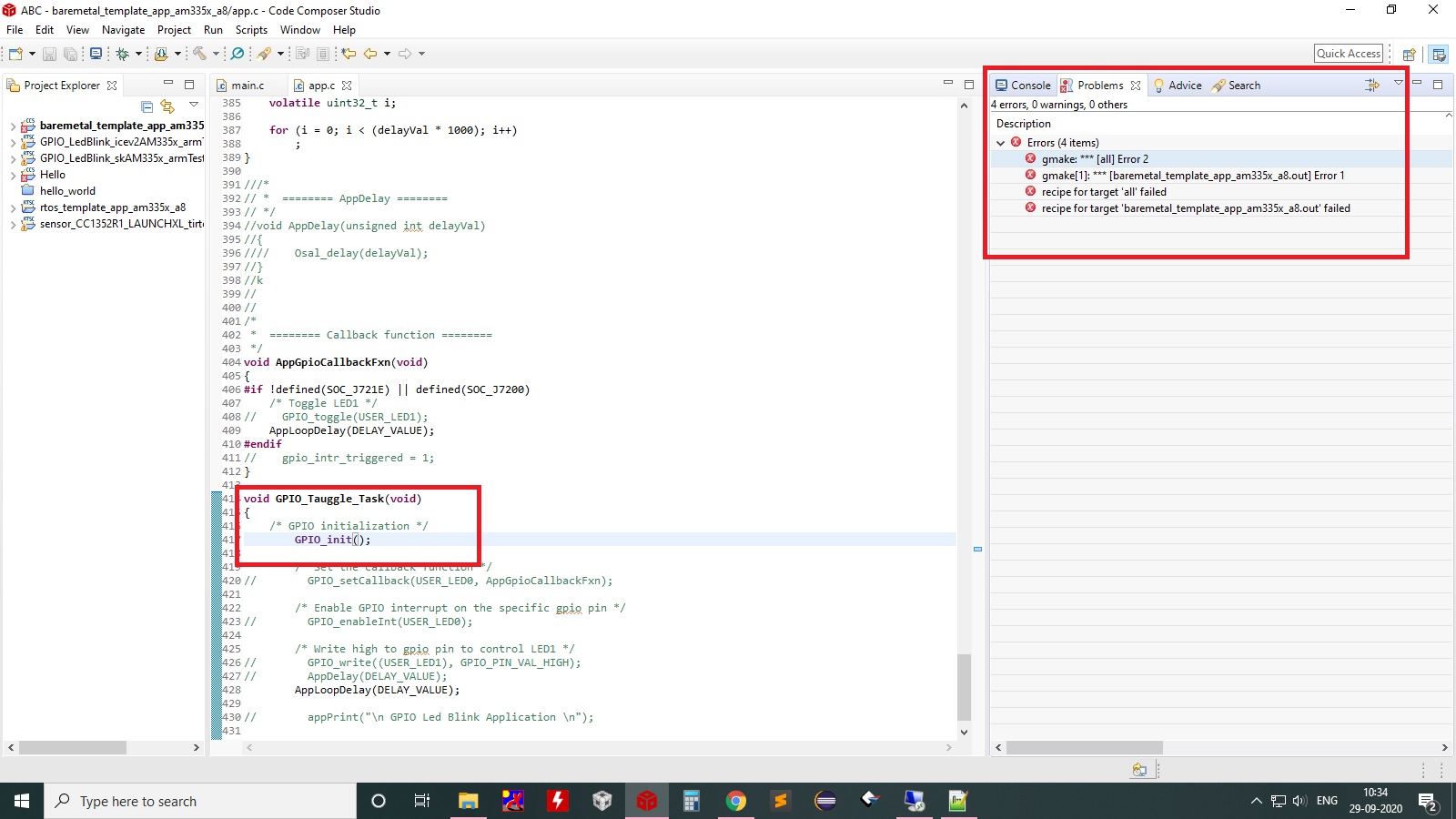

  • Hello Max,
    Even you can check my example that, I am unable to add GPIO_init function. I am getting, why? Because even I added a GPIO.h header also its giving a problem to me.
    Can you tell me, how to add a GPIO tauggle code in this bare metal example?
    Bare_Metal_Ex.zip
    An in this above example i am unable to add GPIO tauggle example.
    I am not getting, why this is that much complex to learn?
  • Hi Anil,
    For starting with UART and GPIO simultaneously, I suggest starting with the baremetal template app.
    It can be found in: <Processor SDK RTOS folder>\demos\rtos_template_app\am335x\evmAM335x\A8\template_app\baremetal
    Max
  • Hello max,
    If you check my post properly, I already attached the same example which you are suggesting me right now.
    With the same I tried to attach a GPIO_init(); function but its showing me an error.
    So that only I posted here.
    and As I worked on MSP430FR5994, there Interrupt means - No need to call UART read function always to read UART. So that I am asking what is the meaning of Interrupt, inspite that I have to call that function always.
    You can see in the image that once i added this GPIO_init(); function i am getting an error.
    Please suggest some working example's to me.
    Anil
  • Hi Anil,
    You'll need to include a GPIO board definition file in your project.
    These files for EVMs can be found in the pdk in the GPIO driver examples.
    Max

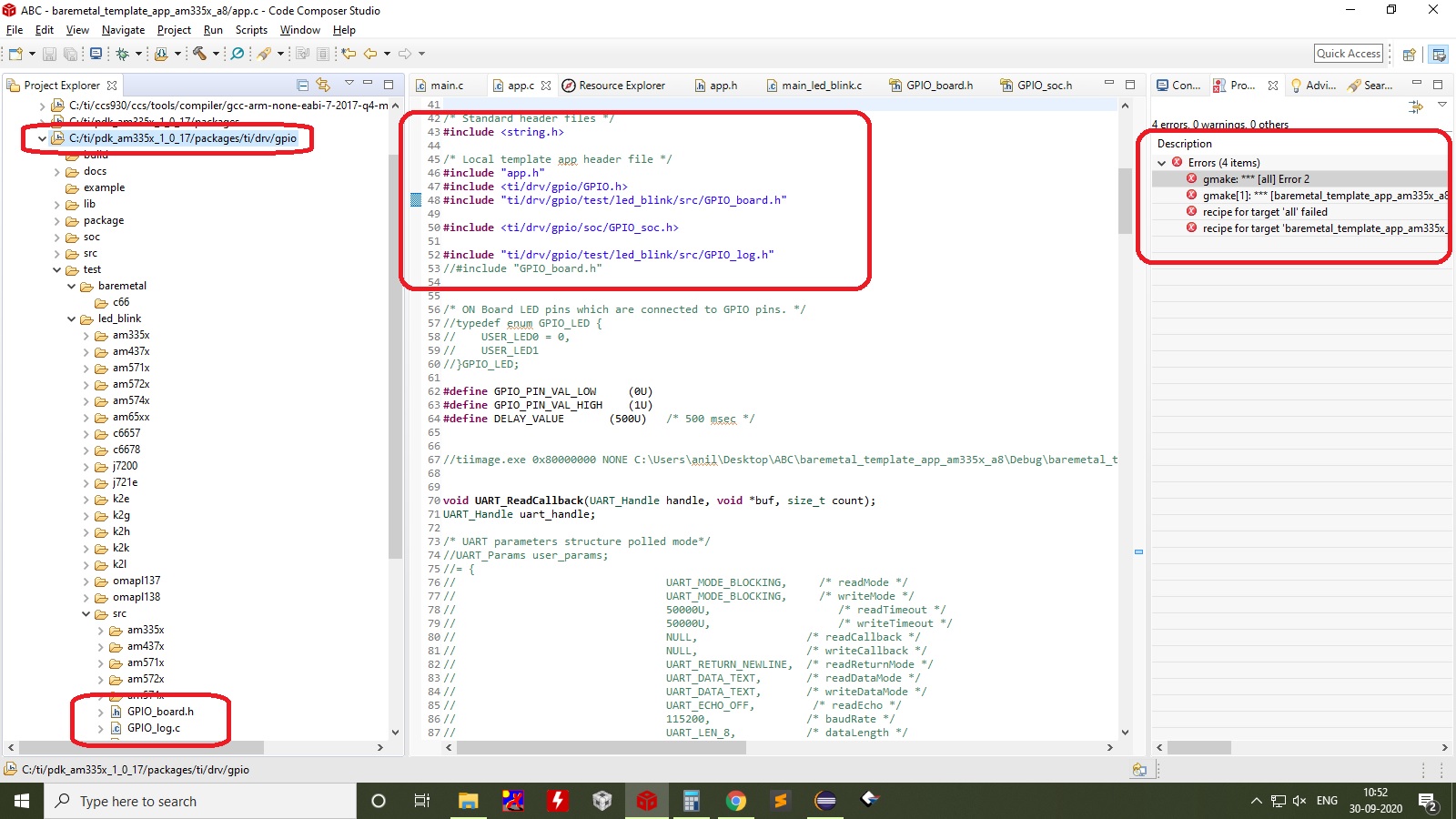

  • Yes Max,
    As you said, I added the library, but I checked that, GPIO_board.h library is already been added there.
    But still I added and compiled it, again i am getting the same error.
    Do I need to add it in Properties -> Build -> GNU compiler -> Directories ?
    Because there also its already added.
    What else we need to do?
    Anil.
  • Hi Anil,
    I'm specifically referring to a file such as "GPIO_bbbAM335x_board.c"
    This is the board definition file for the Beaglebone Black.
    Max
  • Waw Max,
    This is really working for me, GPIO LED1 is toggling perfectly.
    Really thanks for your support.
    Now I am searching for Another GPIO to toggle, I will try.
    Anil.
