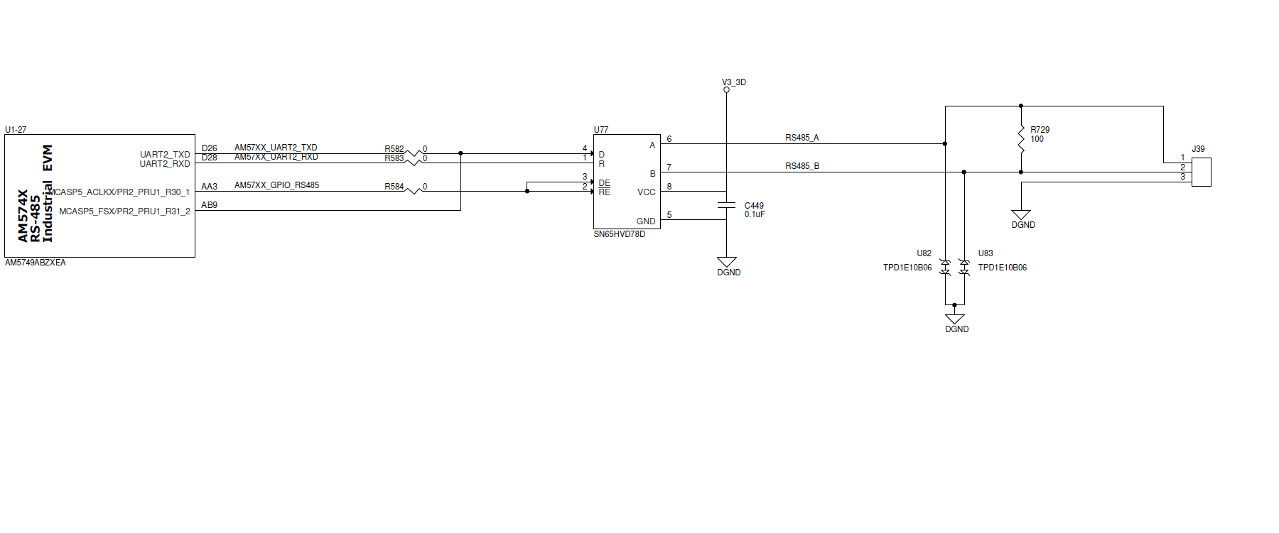

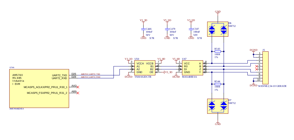

  • Oleg,
    Can you help us with your custom board schematic where you have brought out the UART2?
    On am574x-idk as you know UART2 can not be used. I want to know if that is done differently
    on your custom board so that it can be used on your custom board? Can you show
    us how it is being brought out on your custom board?
    Keerthy

  • Hi Oleg,
    Thanks for sharing the schematics snapshot. I got the checked from our hardware expert who has acknowledged that it is fine.
    All i did was:
     git diff arch/arm/boot/dts/dra7.dtsi
    diff --git a/arch/arm/boot/dts/dra7.dtsi b/arch/arm/boot/dts/dra7.dtsi
    index 8022cec49b..27b90332d1 100644
    --- a/arch/arm/boot/dts/dra7.dtsi
    +++ b/arch/arm/boot/dts/dra7.dtsi
    @@ -628,7 +628,7 @@
                            interrupts = <GIC_SPI 68 IRQ_TYPE_LEVEL_HIGH>;
                            ti,hwmods = "uart2";
                            clock-frequency = <48000000>;
    -                       status = "disabled";
    +                       status = "okay";
                            dmas = <&sdma_xbar 51>, <&sdma_xbar 52>;
                            dma-names = "tx", "rx";
    For me with the above change: echo "hello" > /dev/ttyS1 works.
    I can not test beyond this as my am574x-idk does not have the lines brought out.
    Keerthy
