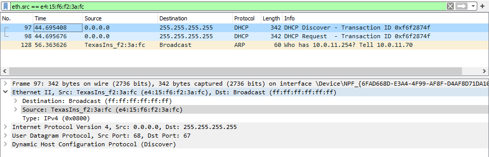

The u-boot is recognizing if Ethernet cable is plugged or is not plugged.
When I try to use "dhcp" command, the u-boot is trying a couple times but with no success.
Using Wireshark I can't see any traffic regarding ARP protocol.
What else should I do to make rmii work?

    After the change did you see any traffic with Wireshark?
    Could you also post the output of these commands:
    mii dump 1 0
    mii dump 1 1
    Schuyler
    No, I didn't see any traffic with Wireshark.
    Moreover, I see some overflow detected in PHY, see
    register: 0x10
    value: 0x2D15

    I see the 50MHz signal on the ETH0_RXD3_REFCLK.
    PHY is switched to RMII mode and is configured in master mode (PHY is a source of 50MHz reference clock).
    Stage 2)
    When I invoke "dhcp" command on the U-boot
    Out of curiosity are you able to use Wireshark to see if there are any packets coming out?
    Yes, I use Wireshark to capture traffic in the network.
    Unfortunately, there are no packets coming out the custom board (DP83822I connected via RMII master mode).
    Moreover I did a test on BBB to have a reference point.
    On the reference board (BBB), when I invoke:
    => setenv autoload no
    => dhcp
    link up on port 0, speed 100, full duplex
    BOOTP broadcast 1
    DHCP client bound to address 10.0.11.70 (3 ms)
    => ping 10.0.11.254
    Using ethernet@4a100000 device
    host 10.0.11.254 is alive
    I get following packets captured in Wireshark:
    Adam
