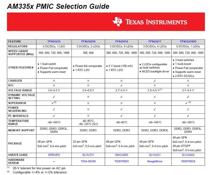

There is a selection guide for AM335x:
Here are consideration from customer to choose TPS65218D0 + AM3352.
1. TPS65218D0 can support DDR3L; DDR3L will be used in customer design;
2. Temperature range need -40~105C;
3. Customer want to use DC-DC to power RTC, it can reduce power consumption;

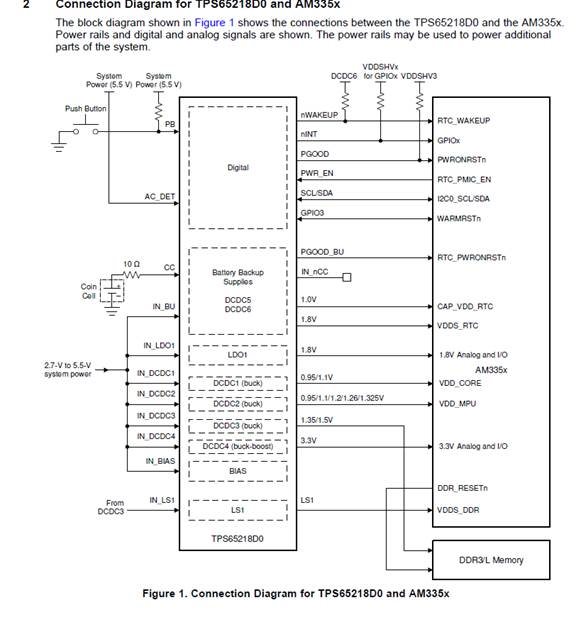

4. In datasheet, it also recommend TPS65218D0 + AM3352:

     Do we have reference design for TPS65218D0 + AM3352 ? This solution is mentioned in the datasheet.
    Customer is design based on BeagleBone black development board, it's a reference design from TI. Here is the link: https://www.ti.com/tool/BEAGLEBK?keyMatch=BEAGLEBONE&tisearch=Search-EN-everything&usecase=GPN
    When customer want to change the PMIC to TPS65218D0, do we need change the SDK of AM3352? If we need change, which part need to change? Could you give a guide for us? Thanks.

  • I ask around to see if anyone was aware of a TI board design that used AM335x with TPS65218D0. I was not able to find a design which you could reference. However, I was told other customers have used AM335x with TPS65218D0. You may want to search both AM335x and TPS65218 E2E forums looking for any relevant posts where other customers have discussed this combination of devices.

  • I will re-assign this thread to someone on the Linux software team.
    Meanwhile you may want to read the an E2E post from the PMIC team, where they just posted a Beagle Bone Black schematic that uses TPS65218D0 to power the AM335x device.
    https://e2e.ti.com/support/power-management/f/196/p/946924/3499187#3499187
    Paul
  • Hi Songzhen,
    To configure TPS65218 in Linux kernel, you only have to define the PMIC in kernel device tree file. The AM437x GP EVM uses TPS65218, so you can use its board device tree as a reference, please check kernel file arch/arm/boot/dts/am437x-gp-evm.dts.
