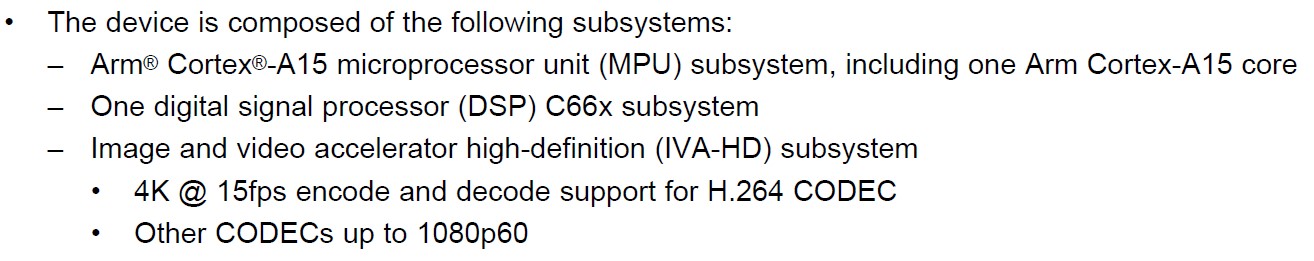

I check TRM spruhz7i.pdf.
So I suppose that AM5706 can support 1080p60 and 4K@15fps.
Is it correct?

Hello Daniel,
Display can support 1080p60.
Video encode/decode can support 4k@15 fps for H.264. Other codecs are supported up 1080p 60.
