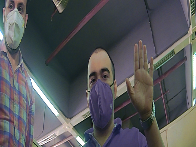

Part Number: AM5728
distortion for example black colour is displayed purple. Please suggest how to correct this. Correct colour identification is required for our application.
Part Number: AM5728
Rashmi,
Can you either snap a picture off the EVM display, or if can you capture to a file using yavta tool, that may give some clue. Usual suspect is the mismatched color format. note that ONLY supported camera capture format is UYVY interleaved mode YUV422.
To debug, you may follow documentations on:
software-dl.ti.com/.../VIP.html
then use a YUV player to play the captured file and see if it is indeed in UYVY.
regards
jian
