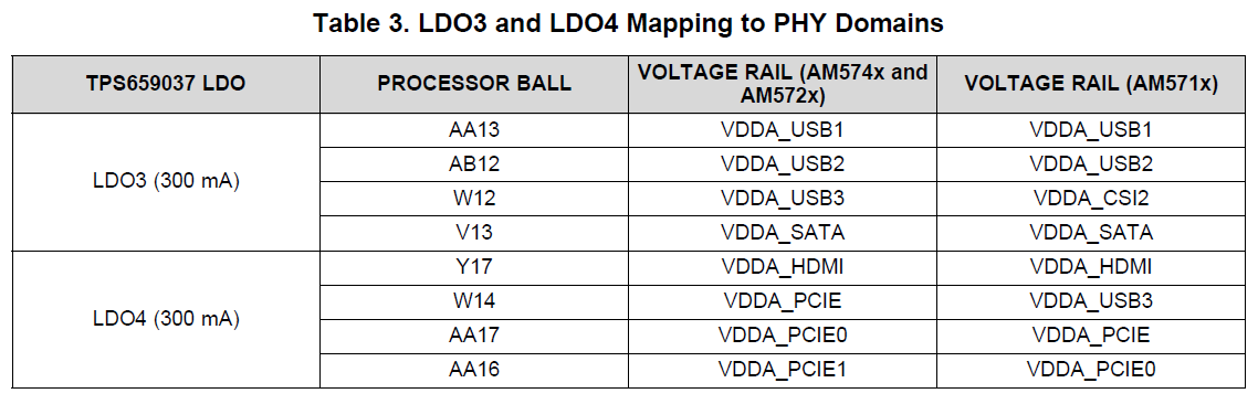

Our customer has an issue with their boards in mass production designed with TPS6590371 a few years ago. The issue is discussed in the thread here: https://e2e.ti.com/support/processors/f/791/t/945139
The current user guide for the power connection with TPS659037 describes for TPS6590378ZWSR and TPS6590379ZWSR the mapping of LDO3 and LDO4 to PHY Domains.
TPS659037 user's guide to power AM574x, AM572x, and AM571x (Rev. F)
https://www.ti.com/lit/ug/sliu011f/sliu011f.pdf
Their boards designed with TPS6590371 have different mapping, are there any problems in that case?
Daisuke
    On the customer's board, LDO3 is connected to all PHY Domains and LDO4 is unused because USB3, PCIe and HDMI features are unused.
    Is this connection inappropriate?

    In the approved and validated power supply connections (Table 8-1) on the datasheet, LDO3 and LDO4 are used for the PHY Domains.
    Should a separate analysis be performed for their board to ensure that the load current does not exceed the rated output current of LDO3?

  • Daisuke,
    Is the customer still using TPS6590371 or have they switched to something newer?  Looking through my various documentation revisions, user guides, etc. it looks like:
    1. The TPS6590371 transitioned to TPS6590373.  The only difference between these two is when the VBUS is present, TPS6590371ZWSR unexpectedly shuts down during a warm reset.
    2. The TPS6590373 transitioned to TPS6590374.  This looks like the point in time where LDO4 was introduced and the 1.8V PHY rails were split across two different LDO's.  I didn't see any other changes.
    3. The TPS6590374 transitioned to the TPS6590376.  The default voltages were updated to coincide with AM572x Rev 2.0 silicon and future variants.
    4. The TPS6590376 transitioned to the TPS6590378 to fix a power down sequencing issue.
    Yes, but that should be simple.  Based on your description it sounds like the only peripheral actually being used is SATA.  Since LDO3 (even in the latest designs) powers both USB and SATA, I don't see any issues.
    Brad
    Does LDO4 have a capacitor on the output?  At a minimum they should adjust their board to have a capacitor on LDO4 so that it remains stable when transitioning to the TPS6590378.
